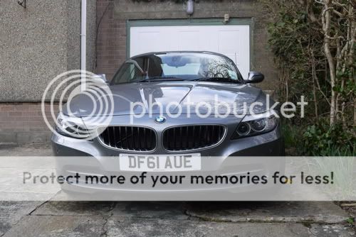

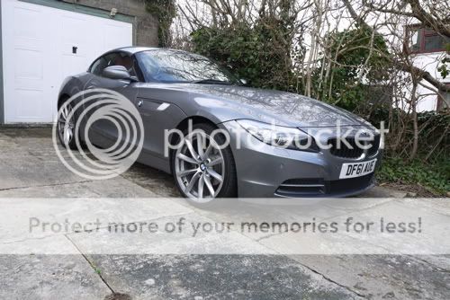

Here are a couple of photos of the dealer demonstrator:
Thanks for the write up and pics A*D demo looks nice in Sterling Grey 8)
