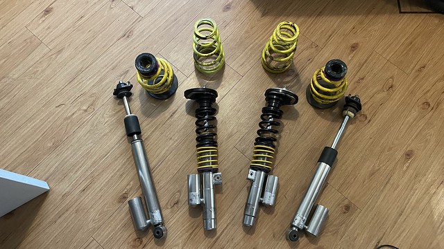

Fitted a full KW V3 Coilover setup from an E46 M3 to see how the fitment went; fronts were perfect, rears had quite a bit of droop. From this, I sold the KW and ordered some new coilovers based on the fact that E46 M3 ones do fit, and there is more choice on the market.

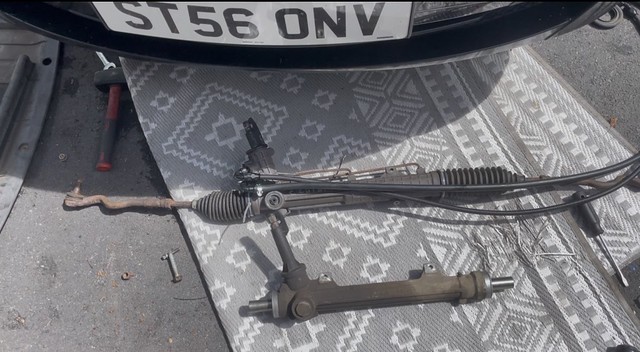

Also I fitted my hydraulic steering setup using a E46 purple tag rack and a power steering pump from a Porsche Cup Car (also used in the Vauxhall Zafira!) A couple of teething problems getting the correct fuse, but it works well and is way better than the crappy electric setup. More precise, better feedback and zero wandering, but heavier at lower speed, which I don't mind. I will get round to doing a video on how this was fitted, but it's quite a cheap swap, costing about £350 in total

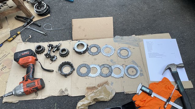

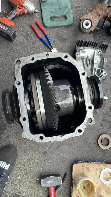

After some feedback from a pro racing driver, I also decided to rebuild and change the ramp angles in my LSD. I was running a 30:60 degree setup which was locking too aggressively, giving the car too much traction and not enough rotation. After reading up on the process, I decided to tackle it myself. Luckily the pressure plates in my LSD had the required 45:45 ramp angles as well, so I took it all apart (on my really clean driveway :LOL:) and rebuilt it. I also reduced the preload to aid rotation. So far so good, and the car definitely rotates better on throttle so it seems to have worked
Very curious to learn more about this.
My '03 Z4 has a very light sticky steering on the really hot summer days (we're talking the 30c days) and when parked outside. Although I've noticed just sticking one of those sun shades / reflectors behind the windscreen seems to prevent it.
But anyways, that and the supposedly better steering feel has put a hydraulic conversion somewhere in the low priority / fun upgrade list of things to do.
What coilovers did you change the KW set for ?
NGL, I've had a bit of a nightmare with this.
I decided to replace them with ST XTA 3 Plus from an E46 M3. They are a 3-way adjustable damper based on the KW Clubsport V4's and a relative bargain at £2000. Unfortunately, after 9 weeks (I was told 10 days) and them still not being put into production by KW, I've had to cancel the order and rethink my options.
The main issue is that I sold my YSR's to a mate, so the cart has been sat on axle stands......
I've had to go for a set of BC DS (ordered 3 days ago) as these were the only ones I could guarantee would be here in time for a trip to the Ring in a few weeks. They arrive in a couple of days' time.

Hydraulic electric steering has made a hell of a difference. More stable at speed, tonnes more feedback nad as the car moves and loses grip it is way more natural to catch little slides on the limit. No big drifts yet so I can't comment on that yet.
