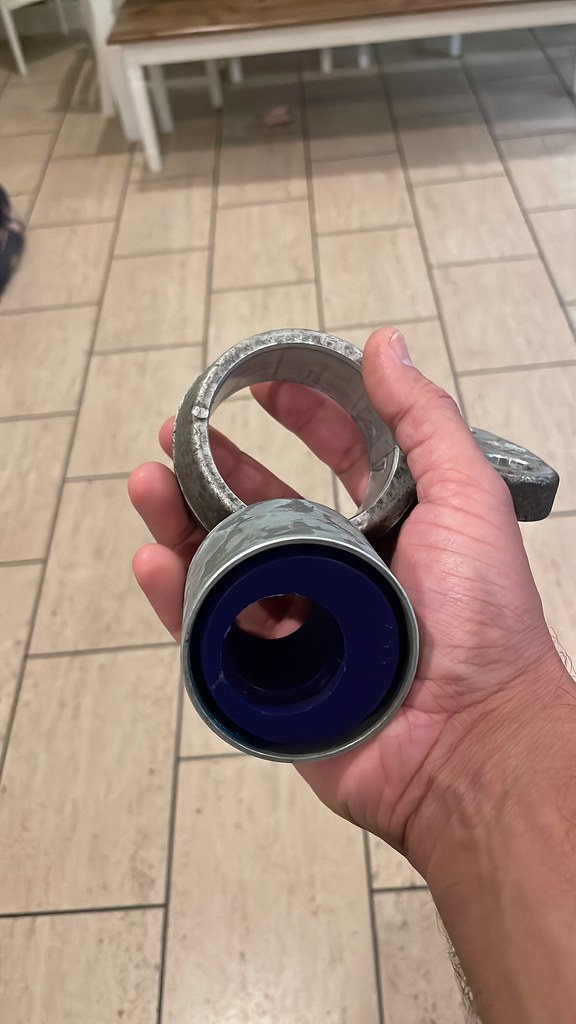

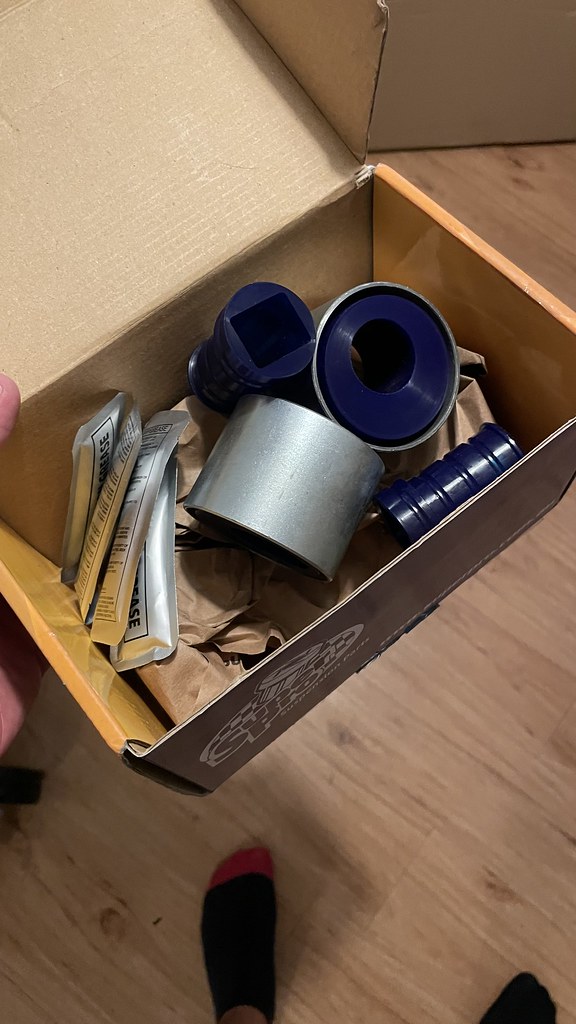

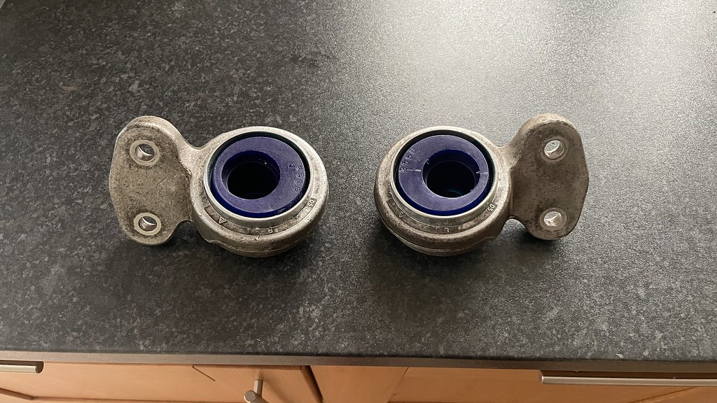

Although the car had already got Powerfelx Road Series front lower control arm bushes fitted, I wanted to move to offset bushes. When a set of Super Pro Offset bushes came up for sale on here by @Sulokim I bought them
Untitled by Damien Bower, on Flickr
Removing the housing was easy, Powerflex bushes were in good condition still

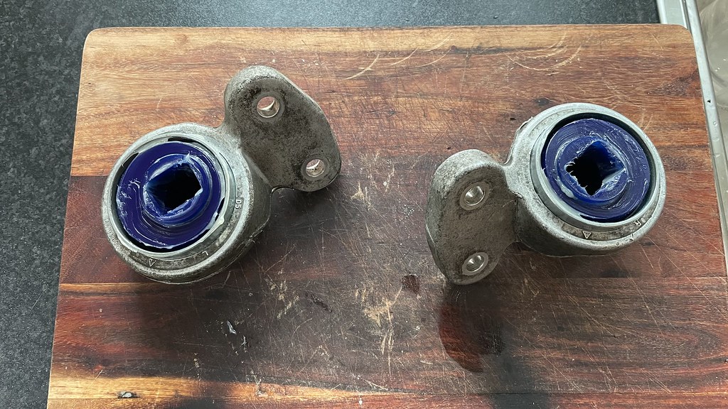

Pressed them out with my bush pressing tool without too many issues. But, I couldn't get the new steel sleeved Super Pro to go in square.
12 hours in the freezer and with the housing warmed in the oven, they finally went in
Greased em up like a good un and popped them on the car, ruining my chopping board in the process :p

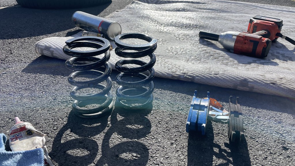

Also, fitted more rear pads :rolleyes: these lasted three trackdays this time instead of two! Any advice on this is appreciated. Minded to stick to Bluestuff as the work and only cost £85 a set.
Also moved to a 12kg rear spring. So now the car is 8kg front and 12kg rear. Should help with rotation but I do wonder if it'll be a bit wild once I put my square setup 225 AR-1 on. Time will tell. I can go to 10kg fronts very easily if it is a handful.

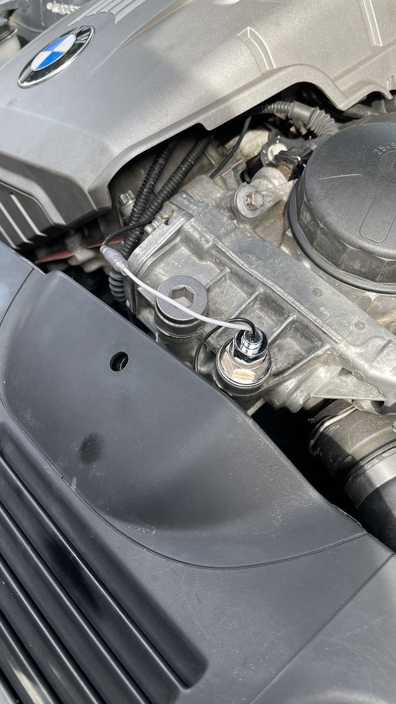

Managed to fit my oil gauge last weekend. I'm not happy with the gauge pod but it'll have to do for now as I am fully out of time but want to see how the temps hold up on track.
Install was fairly easy using an adaptor for the oil filter housing of the N54/55/S55

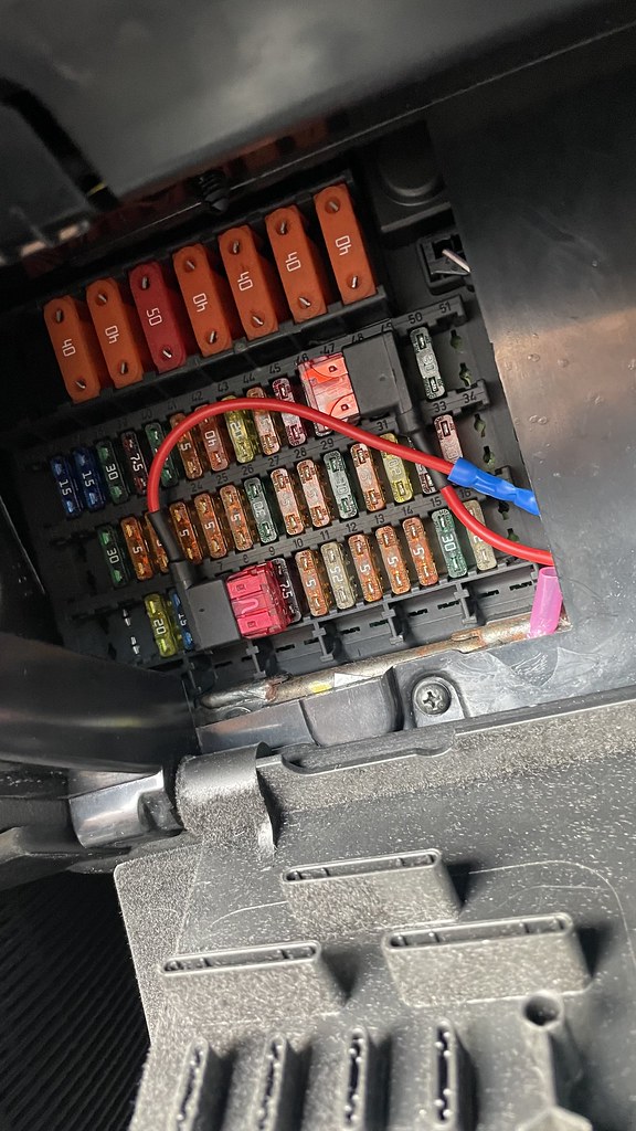

Took taps for the power from the fuse board

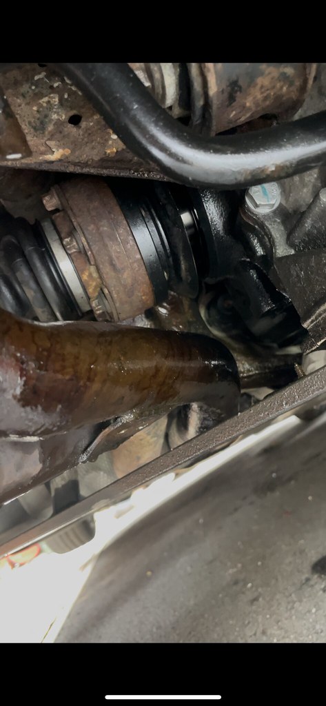

So whilst not a lot has happened to the car, I have had to fix a couple of things. Firstly, whilst being a yobo and doing some 0-60 (5.6 seconds) and 1/4 mile (14.0 seconds) times I managed to pull the driveshaft out of the diff a little.
I suddenly found out that manual driveshafts are really hard to come by. Managed to pick one up from BMW and refurbed the other, plus replaced the snap rings in the LSD so should now be ok. Refilled the LSD with Castrol oil too.
Then decided to replace the gearbox oil and gaskets to the exhaust

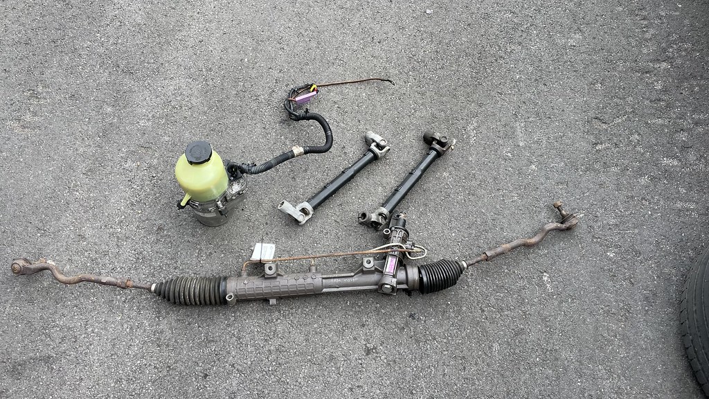

First is a electric hydraulic steering conversion to get rid of the awful EPS, utilising a E46 quick rack and a the power steering pump from a Porsche Cup Car....shhhh don't tell anyone, but its also from a Vauxhall Zafira :rofl:
I just need to work out where to mount this rather large pump and fashion a Z4M intermediate shaft

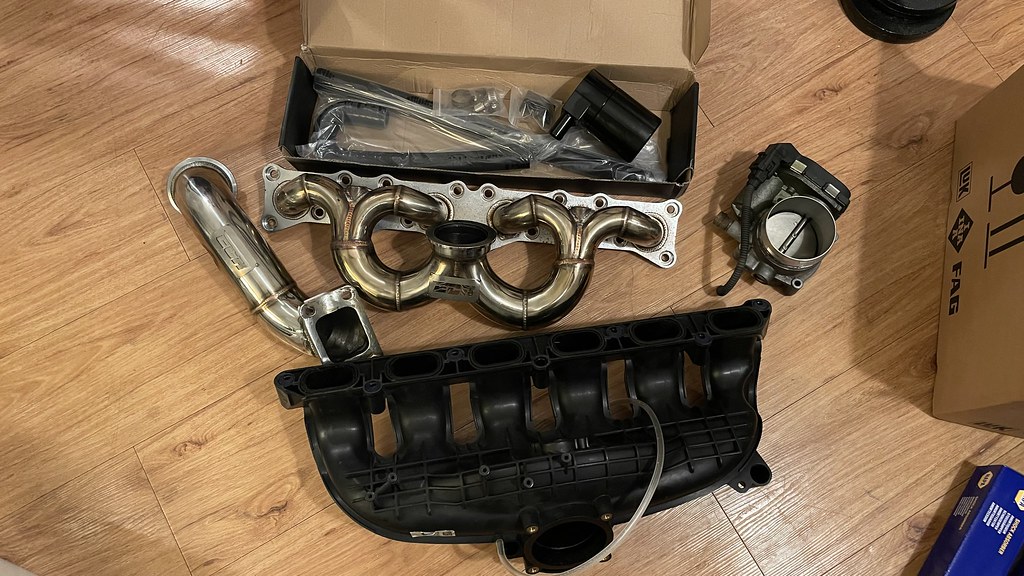

I've begun getting the parts together and so far have the intake manifold (with spacers and throttle body), exhaust manifold and catch can.

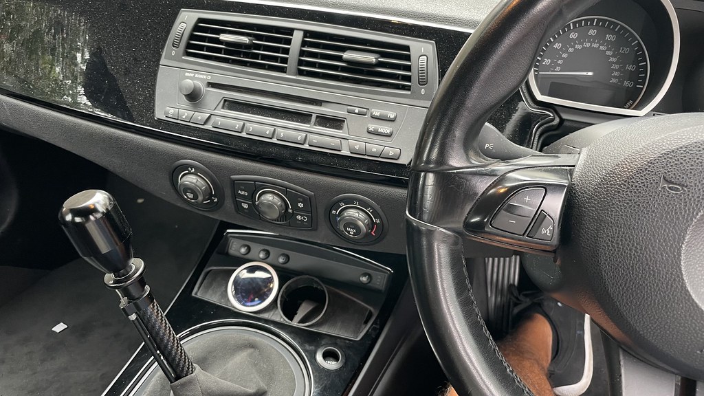

I really struggled with gauge placement, nowhere seemed to work well unfortunately. The 3D printed gauge holder didn't fit at all well in the now butchered :( ashtray....
I'm loving your thread Damo :thumbsup:
Could you not have fitted an a-pillar pod like these, or is space a bit tight?
I had some Defi gauges in my old 200sx, and this was the perfect position :)

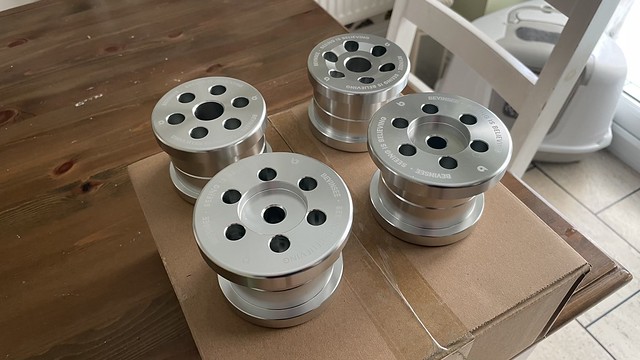

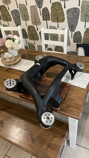

And I've also bought some solid rear subframe bushes to refresh the rear end along with poly diff mounts, new camber arm and inner poly bushes
IMG_5241 by Damien Bower, on Flickr
Once this is complete, all the suspension components will have been upgraded, and a full alignment will be done.....after I've finally got around to fitting my hydraulic steering

Nice alu mounts mate, you’ll enjoy those. How’s the power steering coming along?
Cheers, looking forward to a properly connected rear end. I'm not sure if I am imagining it but I think I'm feeling a little movement from the rear. It defo tramps when the wheels spin too so it needs doing.
