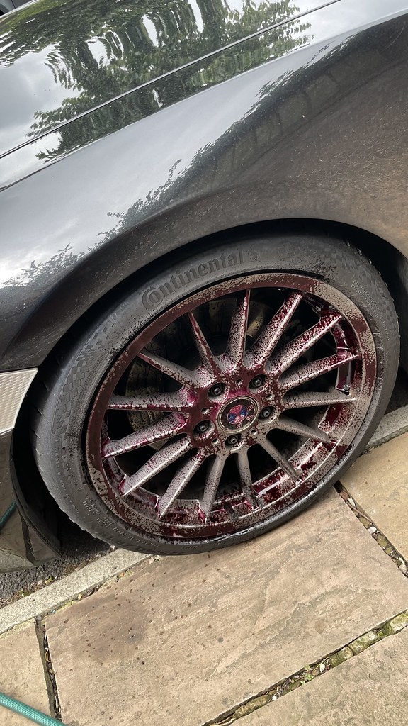

RP-X pads once again performed faultlessly, amazing power from the them, but once I got the car home I noticed the orange brake dust all along the car and clinging to the wheels. I've read the dust from RP-X can be corrosive so a bath followed.
Untitled by Damien Bower, on Flickr

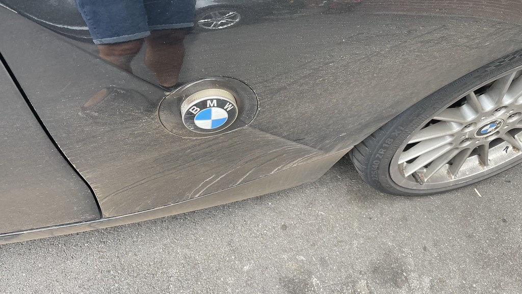

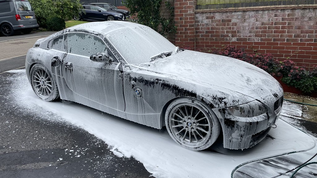

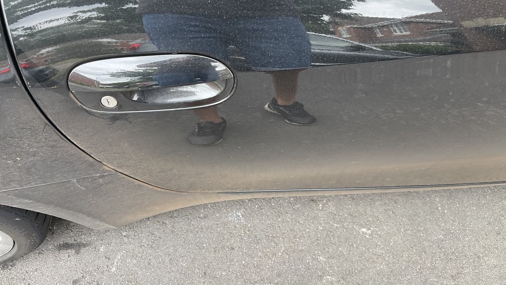

Once clean it appeared as though the dust had removed some of the sealant protection from the paint so ~I'll need to clean the car quickly after each track day for sure

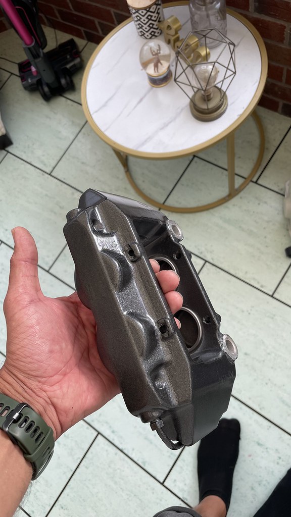

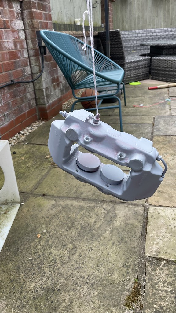

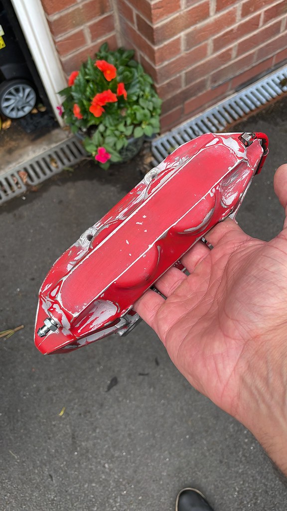

Also, picked up some Clio 197 Brembos which I am refurbing and rebuilding. The plan is to be able to run them with stock 3.0si discs or 325mm M3 discs with a later upgrade kit to 345mm discs. the adaptors are being designed as I speak!
I've calculated that running these calipers on stock discs will shave 3.7kg off the front end and moving to M3 discs will take that up to 6.3kg but more importantly should increase pedal feel

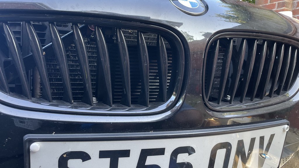

Next track day is booked for the 18th of September so I finally got around to fitting my oil cooler.

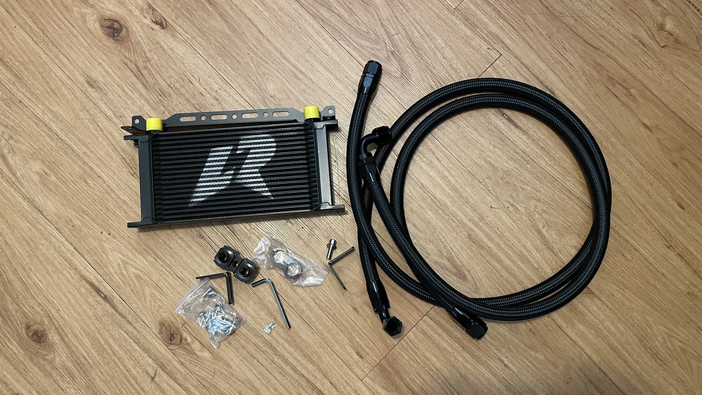

Bruno at BDS told me that oil temps can easily hit 140 degrees in the N52 when driven hard on track. The N52 uses the coolant to raise the temperature of the oil and then try to cool it but it struggles when on track. So to combat this I started looking around at oil cooler options. Turns out the N54/55 and S55 all run an oil cooler utilising most of the same oil filter housing as the N52. The great part about this is that it has a thermostat that opens at about 90 degrees. This means warm up should still be fairly quick, although the coolant now wont help with this, but hte 19 row cooler will keep the oil temps under control when pressing on.
So, what do you need?
  • Front of a N54/55/S55 oil filter housing - managed to get mine from eBay for £40
  • Aliexpress oil cooler kit for the N54/55 - about £110 with all the fittings you'll need
  • New gasket - £15
  • 16mm bung and hose clip - £8
  • Assortment of M6 nuts/bolts and some self tappers - £10
  • Rubber washers to dampen vibrations - £10
  • Oil to fill the cooler and top up once complete
  • Coolant to refil what you lose

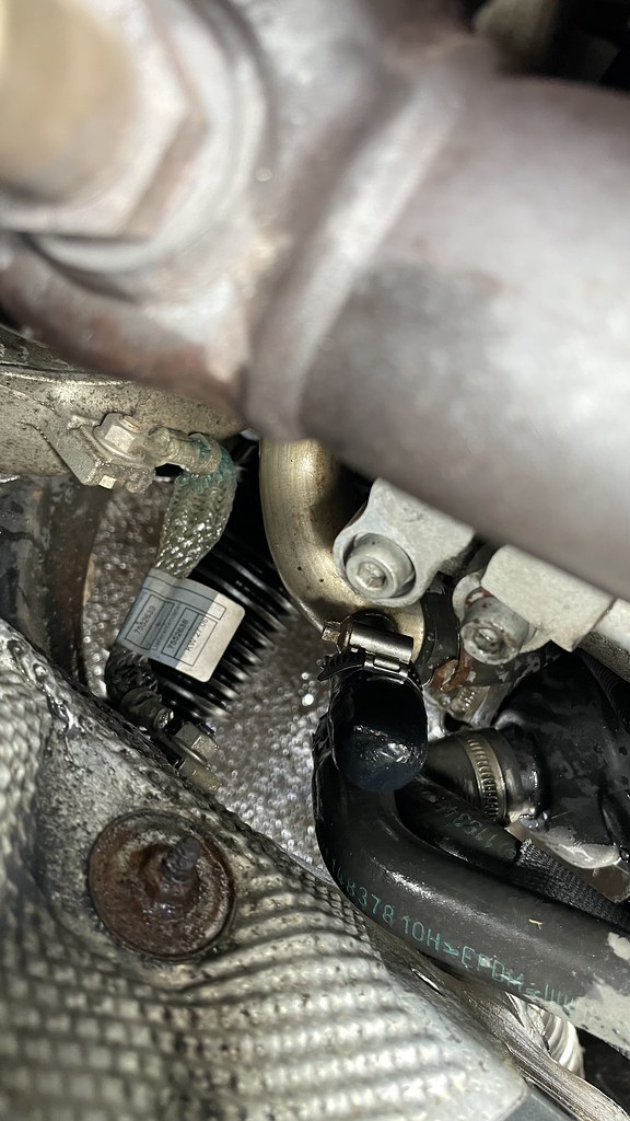

It's a relatively straightforward process.

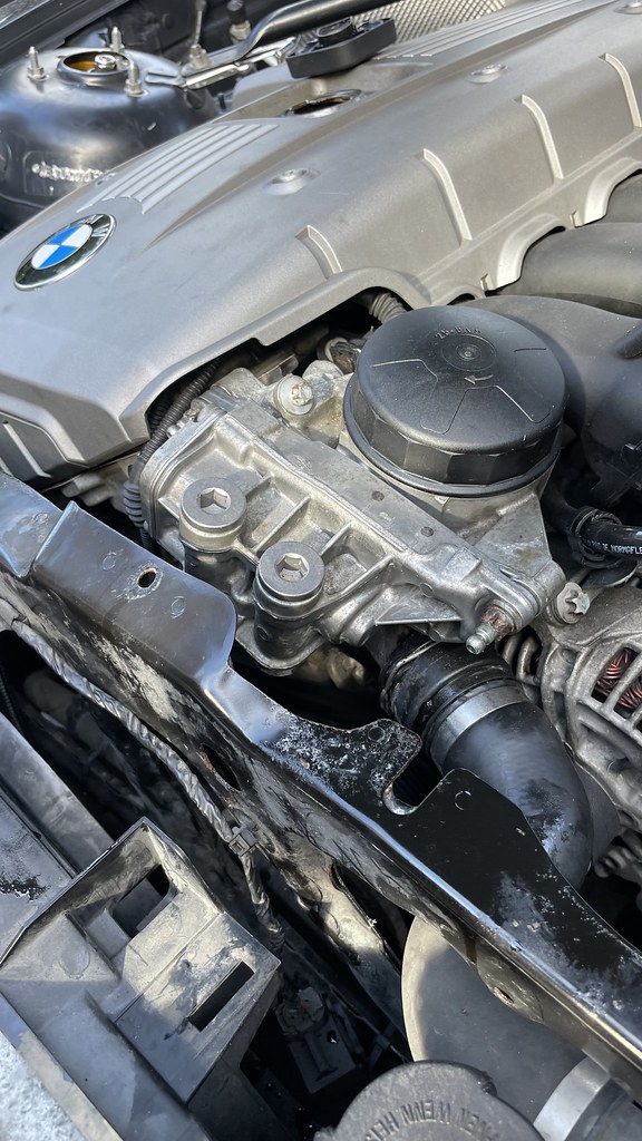

Remove the front bumper and upper cover for better access....Unfortunately I rounded two of the torx screws and had to drill them out
First remove the coolant pipe from the oil filter housing and the lower metal pipe. Be quick with the 16mm bung as you'll lose a lot of coolant if you don't.

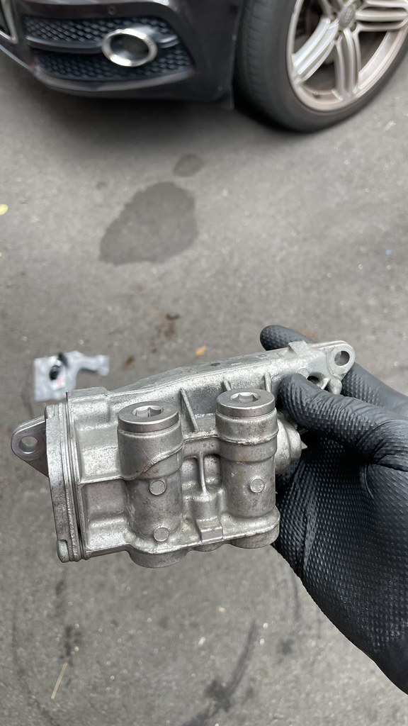

Remove the N52 front part of the coolant housing

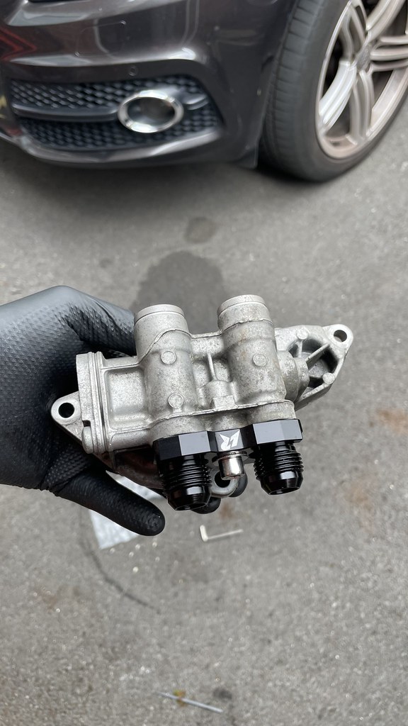

Clean the seals, fit hte gasket and then the N54/55 front part

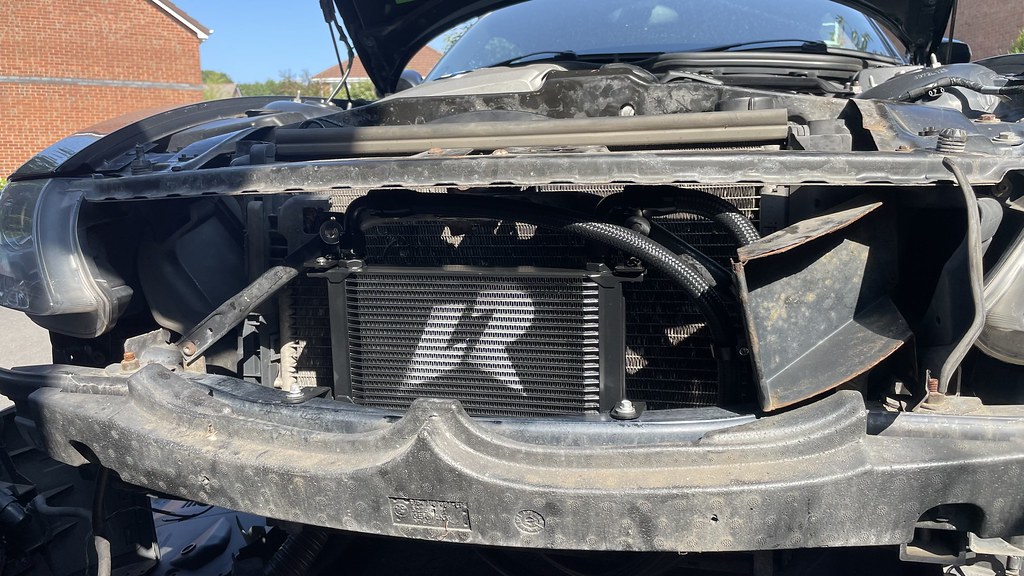

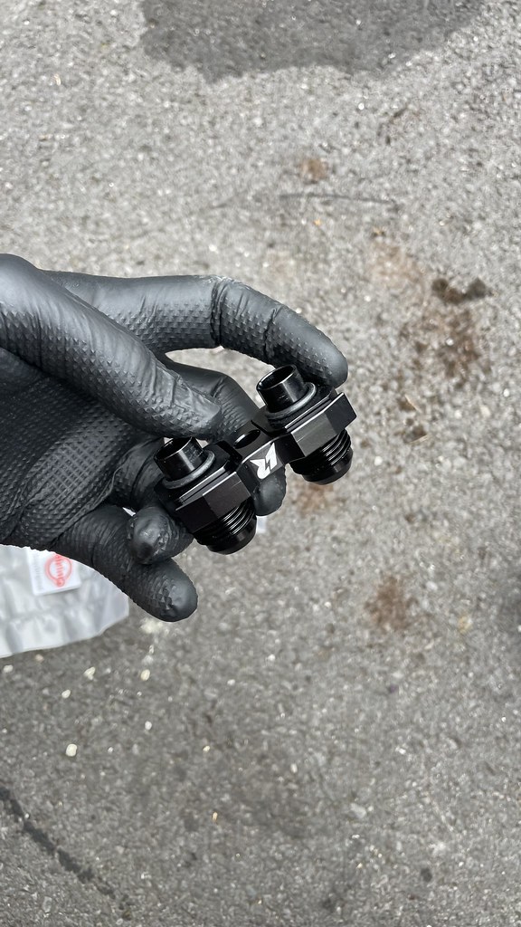

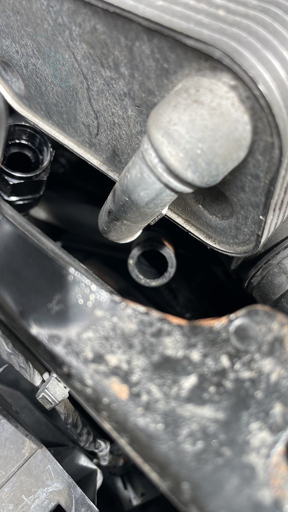

Now comes the tricky bit. The adaptor for the AN10 lines pushes in with a clip that holds them in place. Then an allen bolt secures it all in place. You have to hold the fitting in with one hand whilst trying to get the bolt in and secured. Its a proper PITA. I resorted to using some tape to hold it all together and in place whilst I seated the bolt.
In terms of mounting the cooler it was fairly easy. Drill holes through the bars at the top and then use the fittings in the kit to mount it to the crash bar using the self tappers. Don't forget the rubber washers to dampen vibrations.
Fill the cooler with oil and get as much of the air out as possible. Technically you should fill the lines with oil too but that would cause a massive mess. The lines were the perfect length luckily. I tightened the AN10 fitting finger tight then a 1/4 - 1/2 turn extra with a 26mm spanner.
Refill the coolant and bleed the system.
Refit the bumper and wonder why you have screws left over.
I ran the car for 30 minutes on the drive to check for leaks. Don't forget though, the oil housing has a thermostat; oil won't run through the cooler until up to temp. No leaks so far so I took it for an extended drive with some oil in the boot. I kept checking the oil level which did drop so I topped and and repeated this process three times until I was happy the oil level was stable.
Next up is to fit a oil temp and maybe pressure gauge.

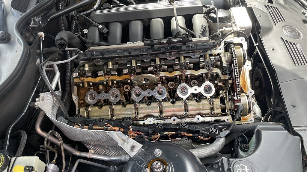

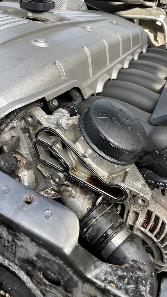

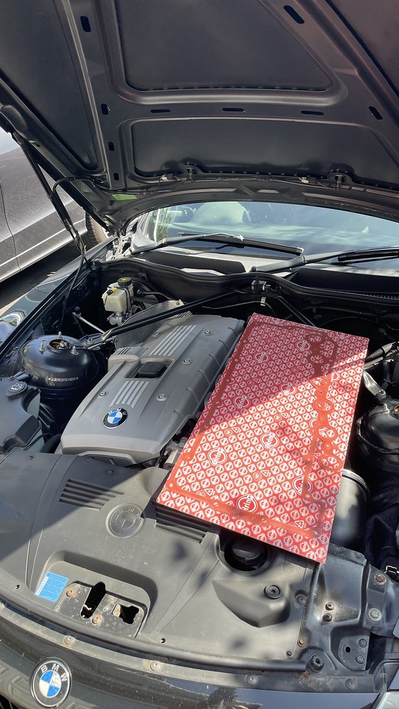

Almost forgot, the preventative maintenance continues at pace.
Valve cover gasket has been changed which has stopped the car hunting at idle when first starting it.
Seems quite clean in there for 115,000 miles and 6 track days. It has had 2 oil changes in the last 6000 miles though witht the last one being before Cadwell.
New valve cover gasket stops revs hunting at idle? That’s interesting.
Yes mate. It seems that quite a few of the N52's hunt at idle when first turning on. The revs fluctuate for about 10 seconds or so when hot then settle down. It can be due to a few things, such as the MAF, CCV system, etc. Those are all new on my car and helped a little, but the VGC has defo made the biggest difference
That’s very interesting. Mine does hunt a little on startup, VCG is leaking a tiny bit at the moment. It’s being replaced on Thursday so let’s see!
Can confirm after getting the car back from Autowerx today that the lumpy idle has been fixed by doing the VCG!
I am trying to think why and I am assuming it's some sort of oil pressure issue caused by not having a tight seal on the cover.
That's good to hear, thanks for letting us know
