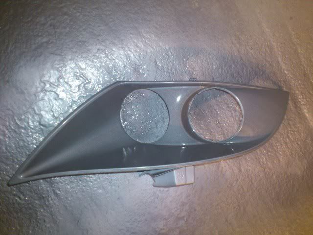

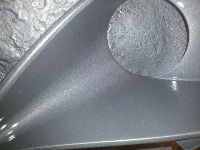

i'd be tempted to fit the black ones, or for a even more unique looks... spray them sterling grey (body colour)
I did the same on my chrome inners. I'm just going to spray them sterling grey to match the car. Won't take long.
Someone a few pages back has sprayed his a kind of dark grey using a heat resistant paint and it looks great.

Thanks guys, I will look for somewhere that does mirror chrome as I like that finish, will get the 2 black ones done then swap them over when i order the M bumper next month. Is it possible to have them chrome dipped or are we talking chrome paint? Perhaps an alloy wheel specialist will be able to help?

Very nice, would love to see a pic of them on the car. The facelift ones on page 1 picture 5 of this thread appear to be a kind of textured chrome, i wonder if I can get some of that stuff in a can. I guess the upside of less of a mirror finish is a more defined Angel eye :thumbsup:
