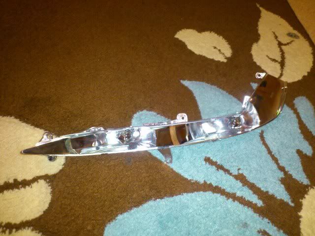

Clears cut from the flood damaged xenons that I bought. They were full of pond life so took a fai bit of cleaning. Wrapped the orange domes as per suggested on here. My ginger xenons were in near perfect condition so it was very scary cutting them open.
Clear boomerangs added. There was loads of little bits of plastic from the cutting all over everything. I cleaned everything as best I could with my roof drain cleaning tubing attached to the Hoover before I took the lights inside (most people seem to do the job in the kitchen)
All glued up and ready to go. Maybe a bit excessive with the silicone but I wanted to make sure there would be no leaks. I glued the 2 parts together then ran a healthy bead around the seam. Can't be seen when on the car.

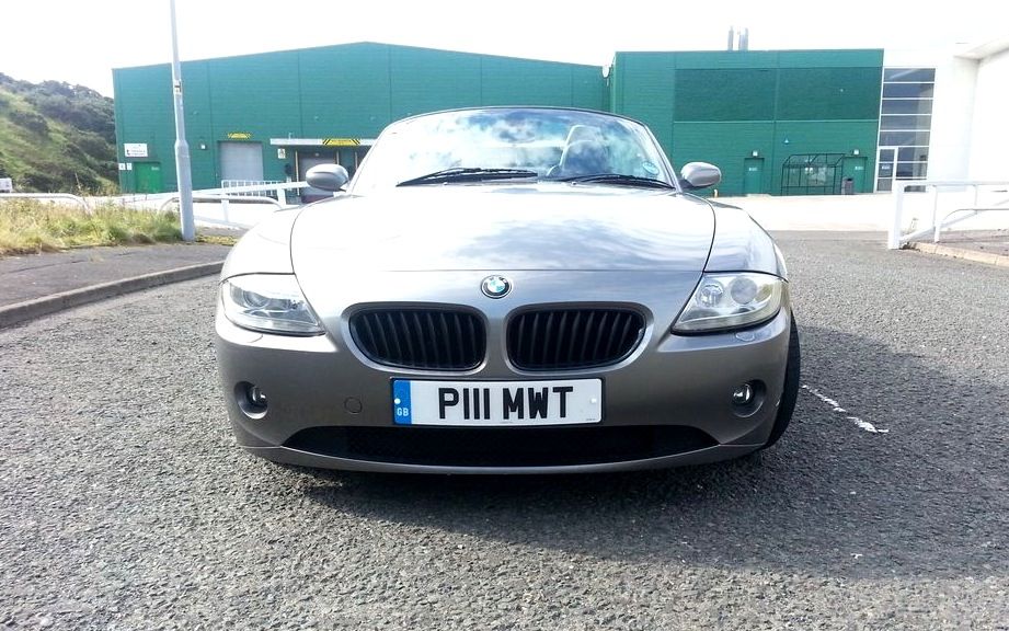

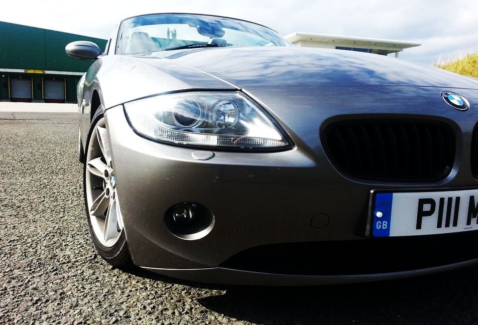

And finally on the car :thumbsup:
Did the side repeaters last month so just need to sort out some rear lights to be a completely ginger free zone.
Thanks to all that gave me advice on doing this mod.
Oh, meant to add that after much consideration I decided not to fit AEs. I like the auto light feature and always leave my lights in auto so they would never be on.

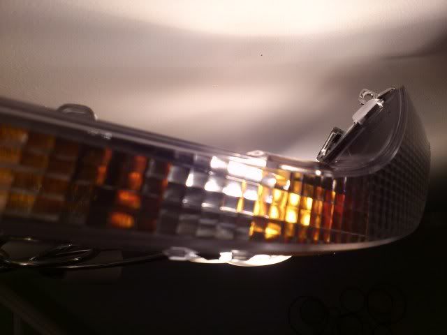

how did you guys go about wrapping the domes with the mirror tint, more specifically the rounded part on the end?
the sides are easy enough, but i had to fold a bit over the ends which ends up in bits overlapping. i then held them up to a light and the overlapped bits are darker than the sides.
would you notice this once it's all back together?
decided to try doing it anyway, and the result seemed ok. can't see any problems with them and used a flashing light app on my phone to emulate an indicator flash, and seemed fine.
I just kind of cut the ends into 4 bits that I could fold over. It looked to me like the ends being so heavily wrapped might have been a problem but when fitted you don't notice as a lot of the light output is from reflection on the mirrored backing of the hockey stick.
