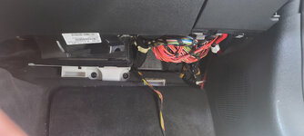

@anubiszed Finally getting around to this Mr. 12 Volt installation.
I'm kicking myself trying to remove the freakin glove box... I've followed your videos, and even have a diagram, but there's gotta be something I'm not doing... How hard is it to get this thing out? In your video, you are specific, but go over it quickly, missing pictures of the screw positions in the rear. I think I can almost recite your transcript from heart by now.
I've also looked at the BMW official picture which apparently was made by someone who intentionally wanted to piss on first timers.
Help?? Please!!! :surrender:

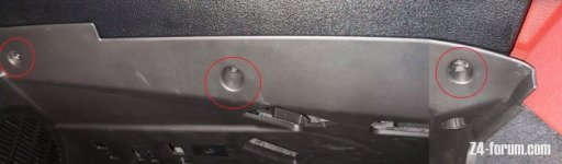

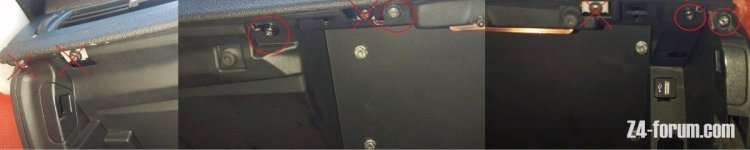

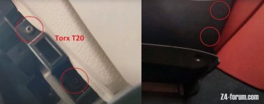

There are 4 under the lid (below the dash front trim)
There's 1 inside on the side
1 at the end (behind end trim)
3 for the footwell kick panel
Remove the long trim and you'll find 1 or 2 hidden
And then one underneath
And that 'should' be it. Now at least that's the righthand drive version, there is a potential of other screws for things I'm not aware of, for instance don't forget the knee airbag!!
