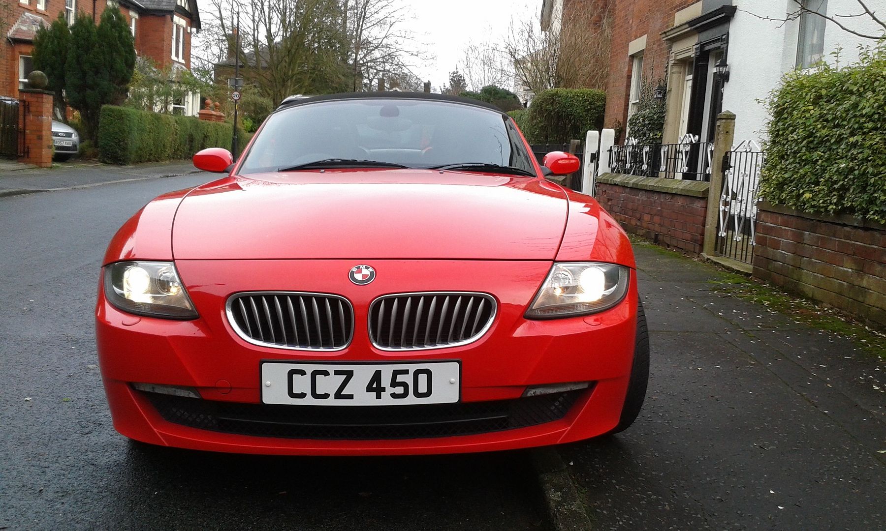

I swapped the old Halogens for Osram Nightbreakers, I also bought LED side lights from Halfords. The side lights didn't work - god knows how , but after I fitted the new LEDs and switched them on the front indicator light came on! I'm returning the side LED's to Halfords and am ordering Osram LED side lights. Anyway here is what the new Nightbreakers look like in the daytime - they look fractionally whiter (I should have taken a before and after pic but forgot ). I'll find out later if theres much difference on the road at night)
