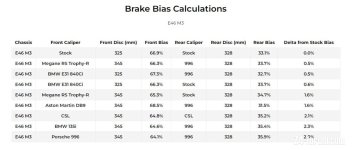

Anyone else running these Brembo (Trophy R) calipers?
I don't know if I'm imagining things but they seem to run hotter than std on trackdays etc, leading me to think the front bias is too much..?
I do have semislicks (Nankang AR-1) now which with extra grip may induce more heat aswell?
New carbotech pads this spring are now only 5-6mm, after a few evenings on Nurburgring and one swedish trackday. In total 7200km in use.
I have my std rears.
Then again, the bias is more rearwards than on a E46 M3 - but more forwards than the CSL (and the Z4M I presume)...?
