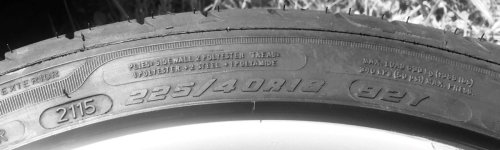

How to read a tyre?
Ever been curious to know how old your tyre is? What’s the size or speed rating? Is my tyre a runflat or not?
Firstly take a read of this, Michelin Tyre Markings 101.. Theres no point me saying the same things but worded differently, best read straight from the source!
Want to do some further reading? Michelin do a PDF guide as well, link here.
Runflat is either mentioned somewhere on the sidewall or abbreviated to RSC.
The tyre age will be shown on a tyre after the letters DOT. They will be four numbers all in one go. If they’ve got letters in keep looking slightly further right of the DOT letters. They will be marked with the week of production and the year. For example from the picture above you can't see "DOT" but you can see the four numbers "2115”. This will be the 21st week of 2015. So to put it in perspective, this is April 2015.
Related to tyre reading it’s a good idea to visually inspect tyres for signs of deteriation. While age isn’t necessarily an indication of deteriation, that is the general rule of thumb. The older it is, the more likely it is to be in a sorry state. So how old? Up to 3 years from the date of the tyre production it can still be fit for purpose and sold as new (provided it is new and unused). After the tyre has been fitted generally the rule is about 7 years till you should replace, or if you get down to the wear indicators, whichever comes first. Now the 7 years is just a recommendation. There is no rule, law or MOT regulation which says that just because it is an old tyre it’s not safe or fit for purpose. If however you’ve got signs of cracking on the sidewall or in between the treads, or even gouges taken out of the sidewall, then these may well not be fit for purpose.
When to change tyres? The guide below covers this, it also covers how to read the tread depth and explains the wear indicator.
To note, the rear wheels in particular have an “aggressive” rear camber set up from stock. This means it will wear on the insides much quicker than the outsides.
This is what Michelin say. If in doubt always consult a tyre specialist!
