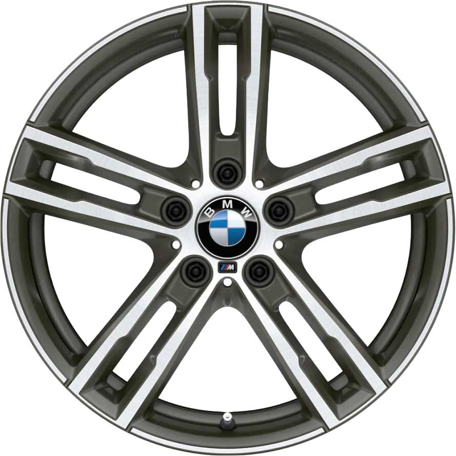

Could someone please identify this wheel for me?
Thank you.. 😁
