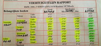

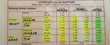

Here is a copy of my geometry settings before and after fitting of the Bilstein. The steering response before the Bilstein was alway very nice. I know with the first geometry setting they did something strange with the rear toe… the difference between the left and right is to big, but the steering felt fine and overall feel thru corners was very nice. But this was in the past and they corrected that toe settings with a new geometry after fitting the Bilstein PSS-10.
What would you advise as geometry settings (camber, toe) on my car (keeping in my mind my steering wishes)… For the moment there is still a slight delay when turning in (that was not there before). Would my car benefit from getting it corner weighted by a suspension specialist?
Geometry 1 (with oem dampers and Eibach springs)
Geometry 2 (after fitting the Bilstein PSS-10)
Side note; When comparing the BMW factory settings of the Z4M roadster vs Z4M coupe there is a difference in recommended geometry setting between the two. The numbers are the minimum and maximum settings advised by the factory. As you can see the maximum camber setting are less aggressive on the Z4M coupe then on the Z4M roadster and the coupe has a little more positive toe (when leaving the factory).
Z4M Coupe recommended by BMW
Front Camber: -1*25' <-> -0*45'
Front Toe: 0*03' <-> 0*07'
Rear Camber: -1*55' <-> -1*45'
Rear Toe: 0*12' <-> 0*16'
Z4M Roadster recommended by BMW
Front Camber: -1*59' <-> -1*09
Front Toe: 0*00' <-> 0*04'
Rear Toe: 0*09' <-> 0*13

Personally, I'm not bothered what the manufacturer's recommended settings are or what settings other people use; what I want from adjustable suspension is a sufficient range of useful adjustment from soft to hard and with the right spring rates for the car, so that I can test drive and adjust the dampers to eventually find the optimum settings that suit my driving style on the roads and track. As you know, I think the Z4MC's OEM suspension is far too stiff at the rear, particularly for road use, so I wouldn't say I like a hard set up unless the road conditions suit. I think that for relatively slow speeds, hard suspension finds all the bumps and makes for a very uncomfortable ride, but at higher speeds on track I think stiffer damper settings give a decent ride with more feedback through the steering and the seat of the pants, whereas with softer settings I find that there is a delay in the feedback because the dampers "dampen" the feedback. I'm using the OEM 18" wheels with the PSS in larger than OEM size which have higher sidewalls, so my suspension settings can tolerate being stiffer than with 19" wheels shod with lower profile tyres. I also like to run my tyre pressures in accordance with what you've been advised by the Michelin techies otherwise the tyres get far too hot and squeal and reach their limits at lower speeds.
I know that on the US Z4 forum they are keen on corner weighting, but I think that most of the advocates of that do "Autocross" driving short courses around cones in very flat car parks. I cannot see how corner weighting can really be of any benefit when driving The Ring.
Looking at your two different geometry settings, in your first one, after adjustment, you had toe out at the rear, which would definitely make the car turn much quicker, whereas in your second settings, you have toe in at the rear. I have my front and rear set at almost zero toe and I find that this gives me a predictable steering response and turn-in. I see you also still have the possibility to increase front camber, so it might be worthwhile increasing it too, because this will also increase turn-in.
Your evaluation is 100% correct… I was thinking exactly the same thing.
I want to try the following settings and see how the result feels...
Front camber: -1*40 / -1*45 (if possible)
Front toe: standard settings
Rear camber: standard settings
Rear toe: -0*20'
If you get another alignment done to your desired settings, you should get the technician to measure the rear toe settings at maximum and minimum points of adjustment, before setting up to your requirements, so that you know the range of adjustment. If after test driving at The Ring you are not completely happy with the settings you have, you could easily readjust (i.e. increase or decrease toe) as a DIY by adjusting equally on both sides. Until you've tried a few different settings you can never know whether the set-up is optimum for you or not, and the reason why I do my own alignments is so that I can easily experiment with settings to arrive at the handling I like best.
I hope those settings work best for you! :thumbsup:
