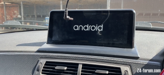

Close up of unit on dash, no gap at front and i have cut lip off x3 base plate
