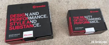

Its a good point :thumbsup:
Frankly I'm not sure..as you know we ended up swapping bits between 3 cars and not sure if I or didn't..anyway fresh pads going in tomorrow..
The front pads arrived today (although they look like they won't be needed for a short while! :rofl:
You can see why they may wear more slowly if contact patch has anything to do with it..

I think paradoxically that because I’m not a heavy brake-er with the weight and speed if gently slowing down the rears are working harder
1st world problems of hooning in the wide open spaces of Scotland..
Let’s see how the new. Brembo HP pads work out..
