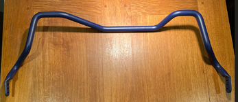

  • Rear anti-roll bar. H&R, maximum setting.
