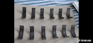

R60BBA said:
Mine in 2018 @ 78,000 miles.
you have a picture where all bearings are shown?

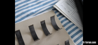

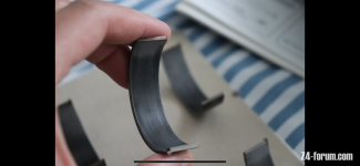

BTW I looked at my rodbearings just to take a peek. Because not much is known on the m54, certainly not when supercharged >150% torque. Plastigauged the old and new bearings etc etc. To gain knowledge.
And now I know :wink:
