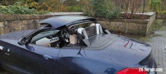

This is the point where the roof stopped on closing. With the rear windscreen still up. It would only shut if I opened the roof fully again then tried closing it for a second time. Do you think this is likely to be a broken wire more than faulty Microswitches or hall sensors?

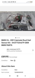

Thanks. The e89 Hall sensor I bought doesn't have connectors ( I believe it used to?). So is it now exactly the same as the much cheaper e88 or mini part?

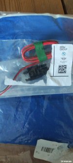

Well Jake,
You are a really complicated guy, aren't you?
The above picture shows an E88 spare part.
Just read the provided details sorrowly and exactly, learn the difference between a hall sensor and a microswitch and have a look (ore even more) into the HowTo section.
And once again a personsal warning: don't discuss your problems in the HowTo's!

That was the only part I bought from eBay rather than from a BMW dealer. So it looks to me me they are selling the cheaper part as the e89 part . I'll return it
Nevertheless, this (E88 HS) is the correct part, we recommend since ages.
And yes, it'll be delivered without a connector.
And yes, it has to be reworked a bit.
And yes, all these details can be found in the HowTo section.
I know I can use the part from eBay but I am annoyed that they sold it as the original e89 part not the much cheaper e88 part. I just ordered a couple from a BMW dealer and they are less than £13 each versus the eBay part at £89.95 each.

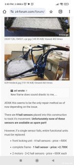

I was thinking that maybe a G29 roof would be easier to fix but it doesn't look like it. See this thread
https://z4-forum.com/forum/viewtopic.php?start=15&t=142146&sid=fc657b3abf2f0f17ac89b6e269524b4b
