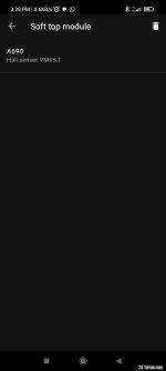

I've got fault code "A690 Hall sensor VSW5.1"on Bimmerlink. Is this definitely due to the Hall sensor as on Staiger Neufen it says A690.is the "Micro switch rear module, closed left" on the fault codes list on https://www.staiger-neuffen.de/cabrio-dach-notdienst-roof-emergency-service/
When I closed the roof it almost closed but stopped with the back windscreen still up on the roof and a red warning light on the dashboard..I turned the ignition off and on and I could shut the roof then.

The problem arises from the incorrect naming in the internal EDSCHA/BMW documentation:
These 2 microswitches are named as "hallsensor", even if they definitely are microswitches. That's the reason, why every tool will present a hall sensor fault. :rofl:

But, I've doublechecked the named fault code list on
https://bmwfault.codes/
which is the source of the Staiger fault code collection.
It states "microswitch" for the A690 on E89's, which is definitely correct.
Having a look on the next line, this code points to a hallsensor, but on 3-series E93 convertibles.
