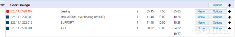

I would definitely do a shifter rebuild while you have easy access to that assembly. From experience, don't bother going with anything other than OE bushes even if the price of the oval bushes are hard to swallow. Not even the fairly expensive Powerflex bushes I got fitted correctly.
https://1drv.ms/v/s!AoAAw4ET48j5hJccIScID_WSu3DKSA
lucasxdiniz said:
AndyBeech said:
Cheers, I'll leave it then, I'm pretty much same mileage.
Ah ok, sounds like a good idea. Do you know what part numbers are needed for the job?
