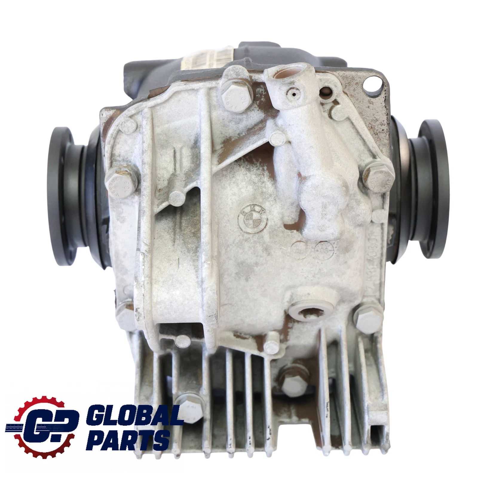

Just got under the car to have a look at doing the Diff fluid change...and I can only see one Drain refill point...is this right? or have i missed something.

I have read that these only have the one fill plug (no drain). To drain, you need to suck the oil out through that fill plug with some sort of syphon/suction tool.

The Allen bolts will be the fill/drain on BMW diffs/gearboxes.
The regular hex bolts in the photo will be to hold on the rear differential cover, so definitely don't go undoing those!

Nope, they'll hold on the rear cover.
Check out figure 4 - do you have that?

no pal it doesnt seem to have a drain plug…
Yep, looks like a suction job then sadly
You can get little hand pumps too, or 12v powered ones
