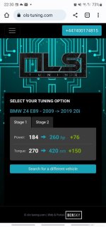

Stage 1 remap on that engine gives power levels near what you are being quoted for "stage 3," bet they charging more for "stage 3?"
Put your details into a few other sites...
Also stage 3 would also normally require other supporting mods such an intercooler, injectors, hpfp or turbo, depending on engine etc.

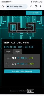

280 BHP and 450 nm is a big ask on a stock motor..
