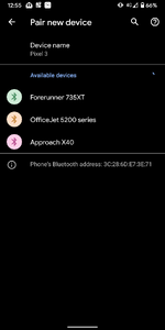

I've re-paired several phones to check to see if the blue tooth was working which it was..some creen shots for you
