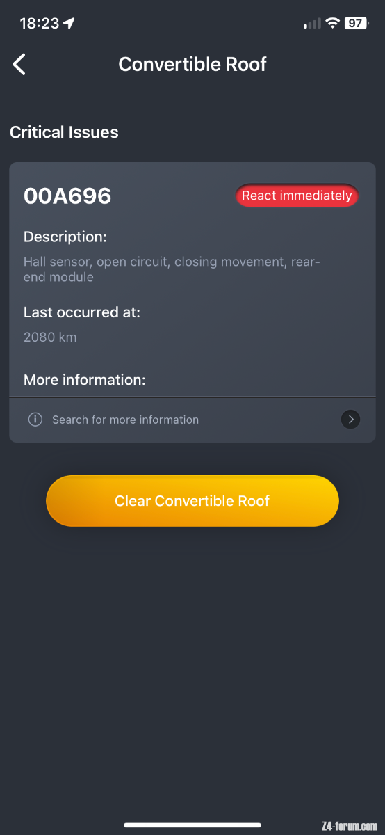

Anyhoo, anyone any tips to get sensor A86 out..? It’s broken a wire which I’ll cut out and splice a new piece in, but I’m not sure how to get the plug end out thats attached underneath the ram…?

I suspected it was this sensor after some research, and at times I could get the roof to open by straightening the wire, but then I couldn’t do that anymore so got Carly on it, code came up with this as well so yes I’m as sure as I can be.RobbiZ4 wrote: Sat Mar 30, 2024 9:22 pm Sure with your diagnose?
If never heard of an issue with exact this hall sensor.
Of course I’m open to any suggestions etc, I’m by no means very knowledgeable on this roof, but I seem to have pinpointed it….i think.

Checked again today Robbi, I’m losing the plot…RobbiZ4 wrote: Sun Mar 31, 2024 11:13 amThe broken wire can't be seen on your pic. On the other end of the brown&yellow wires, the (not visible) hall sensor is plugged into the ram like on my following picture:john-e89 wrote: Sat Mar 30, 2024 5:17 pm It’s broken a wire which I’ll cut out and splice a new piece in, but I’m not sure how to get the plug end out[...]
The two wires wires are casted in the housings of the hall sensors and can't be "repaired", if teared off. That might look like on this picture of an 6-series F12 hall sensor:
Carly isn't the best choice for this topic, as I had to learn earlier as well.
What exact code did you get? [A688...A6A7]
In order to gain access to/remove this Hall sensor, the entire roof structure must be removed with some tricky readjustments. If at all possible I would avoid it just on suspicion!

Yeah, it's not the main pillar's hall sensor.
A696 is the hall sensor on the right hydraulic ram in the trunk as shown on my pic. It may be rusty inside and should be replaced by a new one.
Have a look at this thread
Prepare E88 hall sensors for E89 use
viewtopic.php?t=145813
