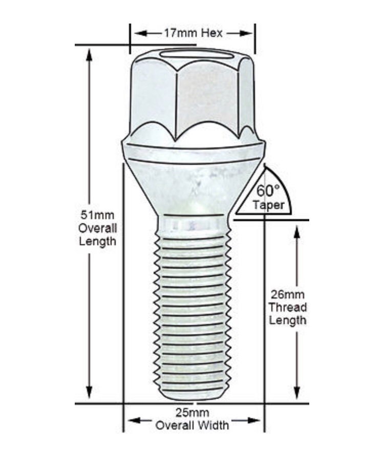

Hi Mack,MACK wrote: Thu Jan 10, 2019 11:41 amThe standard bolt has a 26mm threaded section and is circa 45mm overall length including the head. If this is what you've but on stick with that.SamP84 wrote: Thu Jan 10, 2019 12:11 amI’ve taken the long bolts off and put bolts with a 26mm thread on which seems a pretty standard bolt. Do I need to go down to 19mm thread, doesn’t seem a lot thread.gregl342 wrote: Wed Jan 09, 2019 11:35 pm I've had exactly this before; as others have said, it'll be the long wheel bolts. No need for them anymore as you've removed the spacers right?
The long bolts were replaced with the Ones below. I just don’t understand how these could be too long. Am I missing something?
- 1C9D86D8-8E19-4D27-9B31-6064D82972BB.jpeg (89.95 KiB) Viewed 900 times

Are you sure you didn't break or move something when you fitted the long ones? The noise you hear now might just be from what you did when you put the long ones in.
- Posts: 192
- Joined: Wed May 30, 2018 2:43 pm
19” New alloys issue, help!
No idea, I didn’t put the bolts on. I will take wheels off and inspect... as soon as the jack I ordered turns up.Trav wrote: Thu Jan 10, 2019 11:55 am Are you sure you didn't break or move something when you fitted the long ones? The noise you hear now might just be from what you did when you put the long ones in.
