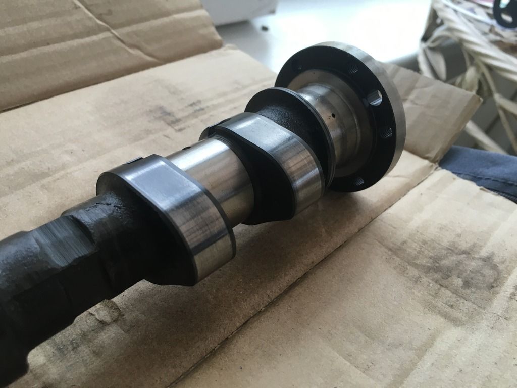

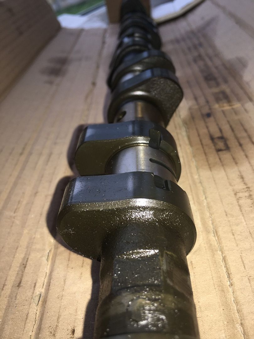

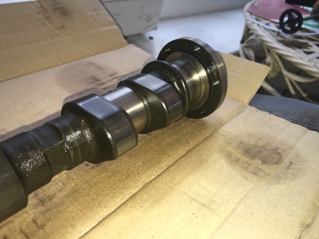

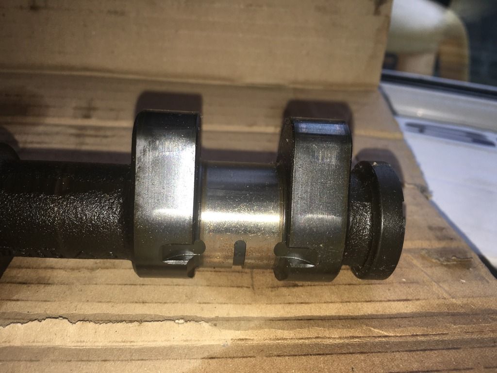

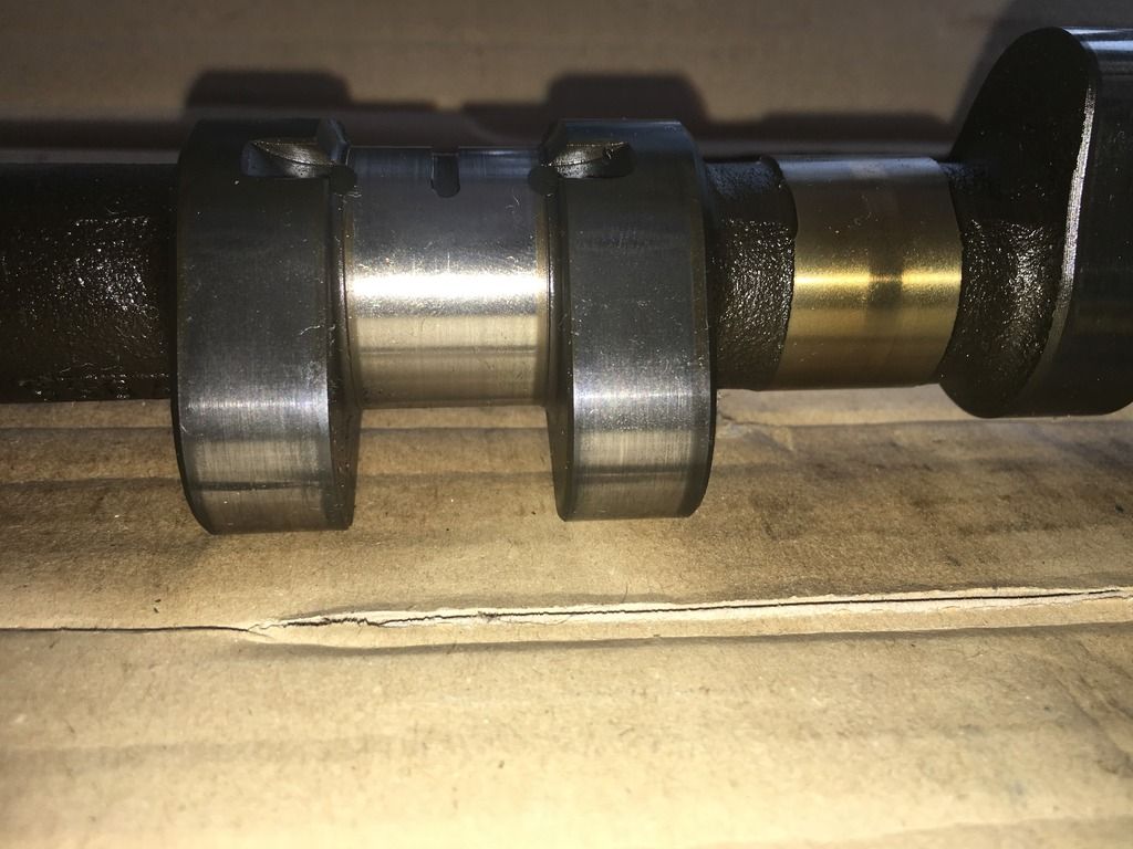

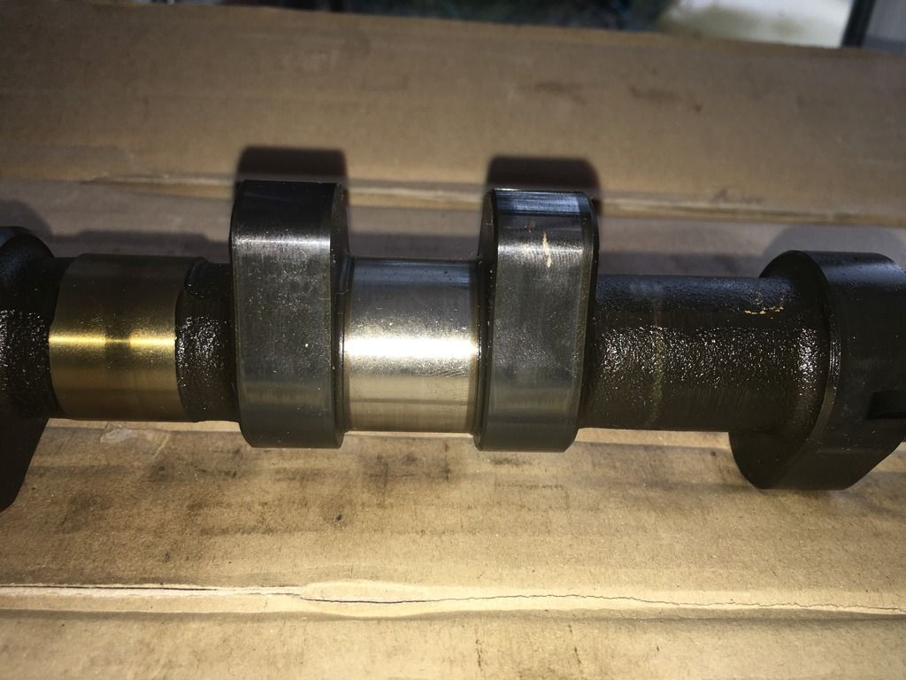

Having looking at the BHP/£ of the stage 1 Schrick I'm hoping these spare ones will be ok. Anyone know if these are knackered? They look a lot better than the ones currently in the car but that's not saying much!
get them inspected properly , do not put a picture up on the internet and let the forum experts give you a nay or yay! just no...
if this was me, id buy new cams, new DLC followers. BUT if those checked out ud be mad to not use them really....

They (the cams) look fine to me, but it isnt looks that determine wear. Obviously you see a wear trace where the lobe has run over the follower. On that crossing line the wear is to be determined. If you feel a transistion you have to look deeper. Normal cams are nitrided (hardening process), and depending on what type of nitriding is used (on cast iron) the penetration depth is between 0,05mm and 0,3mm (normally its deeper, sometimes up to over 1mm but this is taking it on the safe side).
You could measure this with a straight edge and feeler gauge lint.
That is one way of determining how worn it is (as on these cams there is a clear path on where the follower touches the lobe and where it doesnt)
But I dont see any real pitting or marks that indicate wear in tolerance. Wear on looks (like shiny compared to matte black) is imho not a real sign of wear.
But on one of the lobes it looks like there is a knick?
Do you have any pictures of your followers?
If the tappeting sound came from your valvetrain, there has to be a clearance somewhere and a decent tech should be able to measure that.
But as you're not doing the work yourself its best to trust your mechanics judgement. I mean when you have the knowledge to judge wear on camshafts chances are that you also have enough knowledge to replace them :lol:
