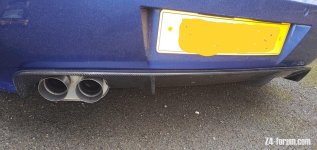

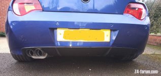

Fitted carbon diffuser from Burkhart Engineering but had to cut some of the carbon fibre away from around the exhaust box due to it being a larger box than standard . Bit of a tense moment when cutting into it to get the correct shape so did it a small piece at a time ending up with 3 cuts to get it right and then sanding to get a smoother edge. I have not sealed around it yet as waiting to see if it moves/settles whilst being driven first . I used some rust killer /prevention on the bumper chassis and some protection paint whilst the bumper was removed . I shall post some photos of it on the car once I have taken them .
Having seen these fitted on other Z's, this will look amazing against the blue of your Coupe!
(A longshot but...) By any chance do you still have the template used to cut the rear bumper? I acquired one of these 2nd hand a while back, however it didn't come with the template, and I don't want to start chopping bits of the bumper off unnecessarily!

Thanks Jock156 - for reference, it is the second last photo that 1536Z4 shared (of the rear bumper, with the white template applied, showing where to cut, where to drill)

Sorry Calps it went in the bin and that has been collected .Didn`t even cross my mind to keep it . Two of the holes were slightly out on mine when I fitted the diffuser and had to drill out the bumper again on the last two holes on the right hand side . Hopefully Jock has that sorted for you . Didn`t get a photo today but looks really nice . It is bloody expensive though once you have paid the shipping and import tax on it .
Not the best photos as it was overcast and had to use the flash on phone camera .
