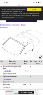

I’m trying to replace the trim that sits around the windscreen- 5 pieces I think? Badly cracked and one corner piece missing.
Top, 2x corner pieces and left/right of the screen
I thought I’d got the right part when I ordered 51317017021, part 2 on realoem diagram
But no- this is the heavy duty rubber that sits around the window apertures and seals the roof leading edge.
So- anyone know where I can source the right parts? Is this more of a glazing firm part as I can’t seem to find on realoem?

That’s the one I bought- and that’s the one that (unless I’ve got the wrong number etc) is sat behind the trim, thicker rubber
I’ll take a pic in am
Pic 1 is what I’m looking for
Pic 2 isnt and already have a spare (which I think is 51317017021)

Update- now have the correct part/seal sourced by Ian from sopers; will aim to replace this and do a how to
