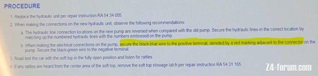

I bought a new motor for my convertible top pump. It was not a Genuine BMW part but fit up perfectly.
The new motor is a different design as the OEM one, so I wasn't able to visually match up which terminal was on the left and which terminal should be on the right.
The new motor has a red dot next to one of the terminals. I am assuming that means it is the positive terminal.
Could you tell me if the green stripe or the blue stripe is the positive cable?
I tried to look it up on this diagram, but it is so small.
