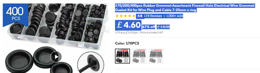

I would be worried that tape will detach when wet
A 9mm blind grommet fits
That is a possibility, but I did not have any grommets to hand and so just used some Duct tape /wiped with silicon grease for now, and yes I have ordered some grommets from Aliexpress :)
