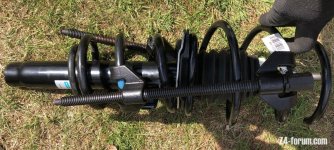

Got round to replacing the front struts...Seeing some struggle with the springs (compressors!)) the easy solution is to use a broken rear spring (weve all got one or two in the garage!) and slide it over the lower strut. The same spring angle keeps the compressors from slipping and pulls it down square.
The new B4's have a 7mm allen /22mm top setup... the originals have a 6mm allen /21mm top set up.. Is this right?
Carrying on with a all four corner refresh....
