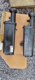

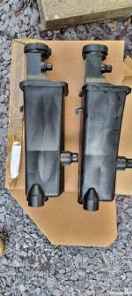

Replaced the coolant header tank which, as usual for me, took the best part of two weekends. Strip down, clean everything not previously accessible, wait for Autodoc, reassemble, test drive, abort when needle started heading to the red, resolve massive airlock, test drive some more. All good.
Whilst it was clear the header tank was pi$$ing out water under pressure, seemingly from the sidewall, there is absolutely no visible sign of a leak. So if you’re looking for a leak, make sure you are doing it hot, not cold.
If you've gone aftermarket like I did first time then expect to be doing this job again at some point in the near future, my Febi tank lasted a year before leaking from the same spot as the original tank.
Bought a genuine Bmw tank this time made by Modine and it appears better built and slightly heavier, I'm hopping it lasts as long as the original tank which made it 18 years
