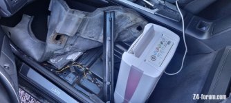

Dried out the foam underneath my carpet today, pulled out just under a litre in 4 hours, fixed the leak in the summer but the foam underneath was still wet months later but the carpet dry, keep getting condensation on the windscreen in that area so hopefully this is the source of it.
