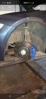

Tonights mission was to umm and arrr about front brake pads. Outer visible pads had about 3 to 4 mm, which made me think they were fine. I had bought some to fit, but thought they were Ok. So, surprise to see the inner pads ( which is common) were a ' lot ' less meat left :?
So, the pistons moved back easily and after a bit of cleaning the slider pins were put back into slider mode from stuck mode :thumbsup:
Front brake sensor was more of a ballache than the rear one. All done in an hour and road test seems , even though its bedding in time to be better than the 'Jurid' pads I removed and fitted Mintex ones.
