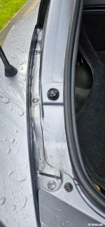

Rained today...and I've still got a leak. :headbang:
Half an inch of standing water in the floor below the storage pocket on the nearside. I've not refitted the carpets yet so it's easy to see.
On the plus side when I aim the hose at the rear quarter window, the water runs down the channel towards the rear light unit and I can see it dripping inside.
So it looks like it's coming in where the wing is bolted to the boot.
Simple answer I can see is to tape it off and put some silicon in there then pull the tape off to give me a nice straight edge. But is there a better method for fixing it if its a known problem spot??20240314_181634.jpg

As for the boot stop, I'm not sure how water can reach that....it's on a ridge which is noticeably higher than the drainage channel. Additionally, when I hose the channel, I get water dripping in. So I may have a leak there....but I definitely have a leak elsewhere!!

As I posted above, I've put more sealant in than before but still getting a drip in the same spot. I'm pretty stumped.
I'm temped to buy some waterproof tape and simply tape the entire channel - it's not visible with the boot closed.
Or clear resin.
Also contemplated putting the car into a bodyshop and getting them to remove the wing and refit it with appropriate sealant between the panels.
I could run some silicone along the seam inside the boot to stop the drip but I think I'd then potentially have water trapped above the sealant, between panels.
Right now, my boot is stripped on the passenger side and I can't put it back together until I'm sure it's sealed up.

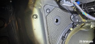

I’ve added a picture the water circled is dripping down an pooling so if that channel is designed to be water tight that could be the same issue

Looks and sounds like you have a leak in a similar area to me. In one of my earlier pictures, taken from your circled grommet and looking upwards, the water is dripping from a seam where metal panels join. Like you, I've pulled the foam insulation out the way to stop it getting saturated (again) and have removed the grommet to let water out the bottom.
I've also bought, but not yet fitted, the white plastic nuts that the light trim screws into. I'm about 99% certain they're not the cause, but right now, I'm trying to eliminate anything I can.
[ref]Z4phil[/ref], Not sure how much of this thread you've read, but I've already replaced my rear vents. To be fair, the seals were rotten and likely not very effective so replacing them wasn't a bad idea, but I've still got dripping water.
I can see the seam where the drip comes from but tracing it back is not easy.
I can't imagine that drainage channel between boot lid and wing is meant to let wat go between the panels, but I could be wrong.

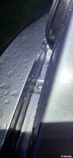

Bit of s breakthrough j think.
Usual drips in the boot this morning but got the hose out and aimed it into the drainage channel...but specifically thr bottom.
No water coming in.
Aimed at the top...water comes in.
A bit of investigating and I noticed there's a gap at the top of the channel....right under the quarter light window both sides are the same.
So that's where the water is entering and working it's way down to behind light and dripping in.
So I guess now I simply seal that gap...but I'm also wondering if it's a designed drainage channel.
Any one have any knowledge of that gap and its purpose??

May be some success here too
Put Captain Tolly’s down the gap in the drainage channel and encouraged it down the seam with hair dryer then about 2 hours later put a maul bead of silicon sealant along the complete length and smoothed out.
It’s been raining where I am again this morning and everything is still dry. Take it out later see if it remains so.
I still haven’t done anything to the boot vents or tail lights as yet.
I’m not sure what the gap is you are referring to is for but mine now has silicone in it.
[ref]Z4phil[/ref], The gap appears to be a channel of some sort right at the top of the wing. Just below the quarter light window. It's the same on both sides.
Driver's side appears to drain fine - hosing that area doesn't result any water entering the boot. But the passenger side was a different story. Hosing that area resulted in immediate drips just above the rear lights. So the channel is either blocked or damaged inside the wing. No way of fixing it without removing the wing. And even then, I guess it's not a sure thing that I could repair it.
Here's the silicone in place and and another inside the boot after rainfall. Typically, that would be wet with water having leaked in.
I checked again this morning and there's about 2-3 drips so I've maybe missed a tiny section. I'll apply some more silicone when it's dry.
