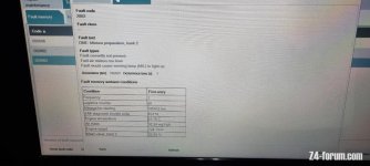

On first fire up left the car to run for 10 mins seems to be running fine no misfires, idling nicely etc still have the rpm surge on cold startup tho was thinking changing so much stuff that would dissappear.
Also on scanning the car with ista I have two new codes for fuel mixture lean on bank 1 and 2 I assume this is a result of the vanos rebuild and the car will learn new adaptations etc.
It's possible I have a leak, I have had the throttle body, rubber boot, idle control valve, disa valve off the car to install the ccv.
I'm pretty sure everything has been put back correctly and I replaced all gaskets along the way.
Before doing the work I've never seen these codes, no engine lights on and ista says the faults are not currently present which from my experience with ista something triggered the codes but they have not stayed active, ie when I had bsd generator fault when the code was currently present I had no charge from the voltage regulator, on changing that part and then getting a charge in ista the code changed to not currently present but remained in the history till I deleted it.
Well if all is good then you do something and faults appear it’s a fair bet it’s something you did.
I just thought it might be an effect of rebuilding the vanos and or replacing the ccv tbh the car always seemed to burn a bit rich on startup and my spark plugs are mostly sooty, I've deleted the codes I'll see if they come back and I'll check if carly and my cheap code reader find the same codes.
I think it was a blip on startup as it does say that it would cause the engine management light to come on which it hasn't, I'll soon know if its a problem next time I scan the car
