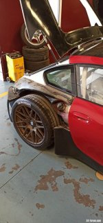

Lol yeah, just considering this picture, you can see how much of the rear wheel arch has been cut out and that to the extent of the amount that the car is now lowered. That's just one of the small examples on this car.
And as an example of what you can't see in this pic is that just as much has also been cut out of the inner rear wheel well, and rewelded structurally to make the wheel sit like this and have enough room for suspension travel, taking into account that proper slicks will have a bigger sidewall.

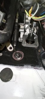

I tackled one of the jobs I've been putting off for heaps as it's an absolute cee you next Tuesday of a job. :!: Be sure i changed the brake ratio, and moved the pivot point upwards by 28mm, I had to do the same to the master cylinder.. which I put off for a while . Anyways, tackled it's few days ago, and I gotta tell you, it's not a fun job,took me the whole freaking day. And at the end of it, I was just absolutely farked...
But we had success, and here it is without further ado.
The hard part of this job is that the pedal box has to stay exactly where it is , and only the master cylinder and it's mount has to move up the same amount as the change in pedal ratio.
Pretty darn choofed with how that turned out. Had to grind a notch in the fire wall by also around 23mm and the metal pedal box frame behind it.
Pretty difficult job that, but sorted it in the end. :thumbsup:

Be sure i changed the brake ratio, and moved the pivot point upwards by 25mm,
What was your reason for doing this change ?
He removed the brake booster and ABS system as he is doing track use only, goal being to have a more predictible response. When using the brake booster you can afford to have a low ratio as the force you apply from pedal to master cylinder is amplified by the booster and the low ratio makes the pedal feel stiffer by reducing travel. Once you remove the booster, you need to increase the ratio otherwise you'd have to push too hard on the pedal. You allegedly still have a stiff and direct feel thanks to the reduced amount of parts on the system while shedding weight and reliability risks.
Hi axelleveau ,
Excellent explanation . Thank you . :thumbsup:

Had to remove the brake pedal again as the spring tension tab was fouling the custom eye bolt.
So yup, cut the tab and reweld it 7mm higher.
Took a while to get it perfect.. now it's sorted
.here's a few quick and dirty mud maps of the new master cylinder mount.
