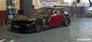

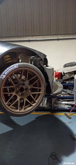

Good to see an update but ..................
any chance of a close up of the wheels so we can see the colour you had them painted and I would personally prefer the sound of the car rather than music :poke:
Cheers :thumbsup:

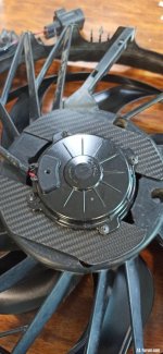

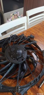

Spal thermo fan installed with overide on/off switch. Weighs 1.7kgs less than OEM, and has more CFM.
Due to no longer having a condenser, the flow through the rad is pretty awesome and thus doesn't require the huge and super heavy 60w OEM fan.

Liam, yup, well as plug and play as this whole car is.. lolol. had to fab the new mount, but aside from that, yeah, its a pretty easy install..

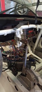

Made some headway with gauges.. added the rear diff temp gauge, wired that up finally, had the sensor installed when I replaced the crap Oem lsd with race spec diff from racingdifs.com (complete other story in itself) :evil:
Boost gauge sorted, though currently disconnected for the paint shop. And gotta clean up the dme box wiring a bit. :poke:
(Those of you with eagle eyes can probably spot the oil px wire I stripped for testing… lol amongst other modifications.. :rofl:
The race dash will run the low oil px idiot light, as the 7v Oem dash one doesn’t cut it, comes on way to late.

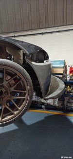

Took today to sub in some steering stops, the penalty for going so low and 295 on the front is that the wheel catches the rear metal part of the inner wheel well.
So I furbished some 38mm bumpers.
:lol:
Pics attached as your probably wondering what I am on about.. lol
And then started to tidy up the electrics a bit... Lololol..

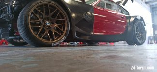

And then shot a pic to capture how low this car actually is..
