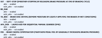

Do you mean dynamic brake control? It does unsettle the car by drastically increasing braking pressure when quickly getting off the throttle and onto the brakes.
It is easily deactivated using NCS Expert/NCS dummy.
You need to find BB_RAB and select Nicht active
Thanks. Got the kit just haven’t gotten round to it.
It’s a strange feature for a sports car to have. Just thoughtlessly carried over from the rest of the range, maybe.
It's for help in emergency stops basically. If you go really sharply from throttle to braking it assumes that you're about to crash and assists you by braking even harder than you did. It's very annoying on the track though...
