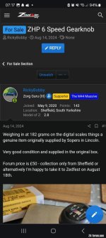

Mines for sale on the ZRoadster forum
https://zroadster.org/threads/zhp-6-speed-gearknob.70379/
As you say lots of fakes being sold on eBay unfortunately.

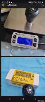

So I dug them both out today and the F10 version seems to be about 10mm shorter than the Z4M version, but more importantly about 60g heavier.
Terrible photo, but the connector looks identical on both.
But as I said earlier the F10 version comes fitted with the gaiter and F10 surround so you need to deal with that, and it cost me just over £150 from Cotswold BMW last year. But they said they'd had loads of orders from E46 M3 owners recently so it seems popular.
If you want to go Carlos Fandango the part number for the F10 one is B25.11.2.284.205.
But getting back on track the ZHP is so much better than the OE fitting, so I'm using the non-illuminated ZHP on my car instead of the standard illuminated one.
