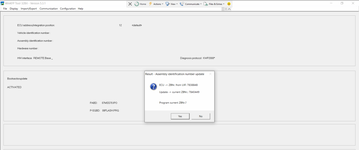

Hi Martyn, I have used WinKPF and in my case, the software has identified *212 as an update
My car is a DU93 (LHD US Coupe), if I wanted to move it to LHS EU software, as I have Euro exhaust, etc what would be the steps on WinKFP to move to that software? is it possible or it goes by VIN.

Instead of using 'Update ZUSB' you can simply do 'Choose ZUSB', select MSS70 and chose the software version (7840461) you want to flash.
