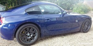

I do bang on about Apex wheels here is our Mr Blue in his new shoes 18x10ET25 rear 18x9ET30Front.attachment=0]IMG_20200927_081437 (3)MOIZ4.jpg[/attachment]

Mr Blue is looking good, and no rubbing with these offsets?
I'd agree with pretty much everything Beanie wrote. The M3 e46 18s are a good wheel, cheap and fit well. Usually you can find them for a couple of hundred or so, I used to have a set a while back for winters. Same widths as 224s but a lot lighter.
