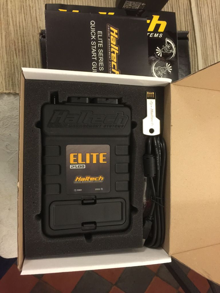

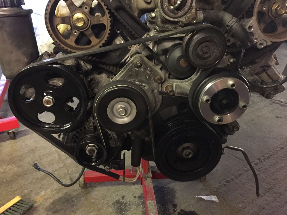

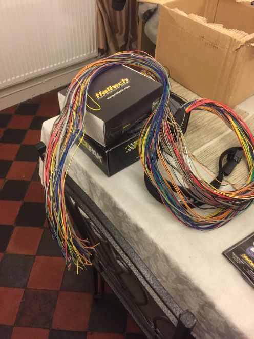

So what have we done.... We have tided up a lot of engine bits. And welded fittings on to crank cases. Brought modded and fitted new trigger wheel for the crank sensor. The amazing ECU has arrived and generally been busying away making fixing painting and sorting all the little bits that take so much time but need doing.

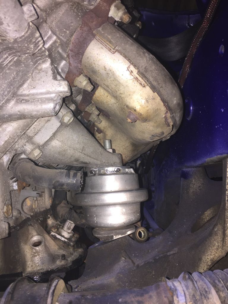

The mount is no aligned in its proper and final position

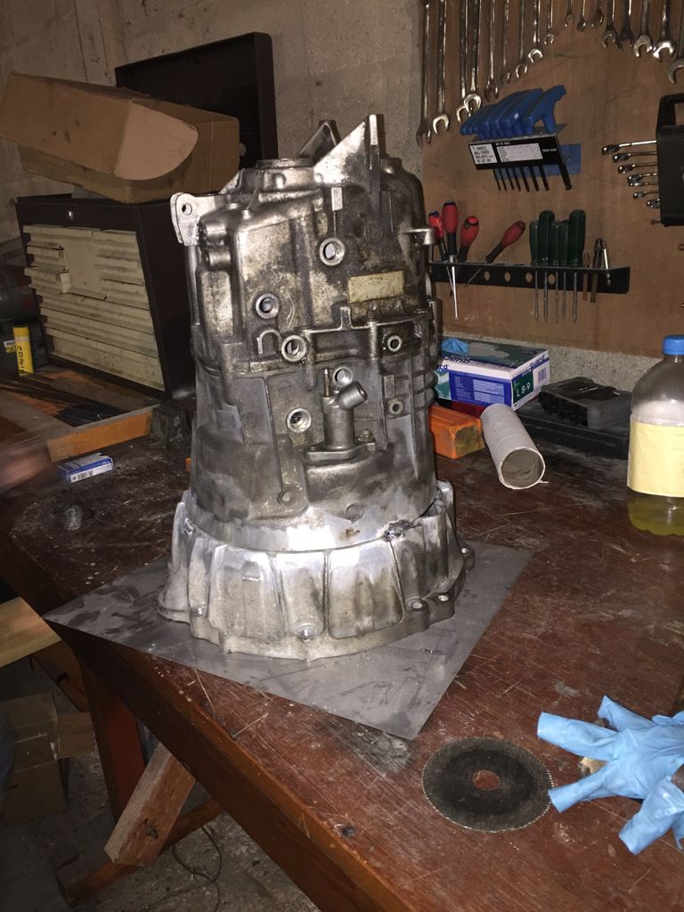

And that's not all... We had been putting off work on the gearbox for a few reasons. 1 it being very difficult 2 it was going to cost quite a bit to perches all the clutch parts. We we started it and its finished. It seems to have gone very well but we wont know for sure until we actually try using it.
The steps

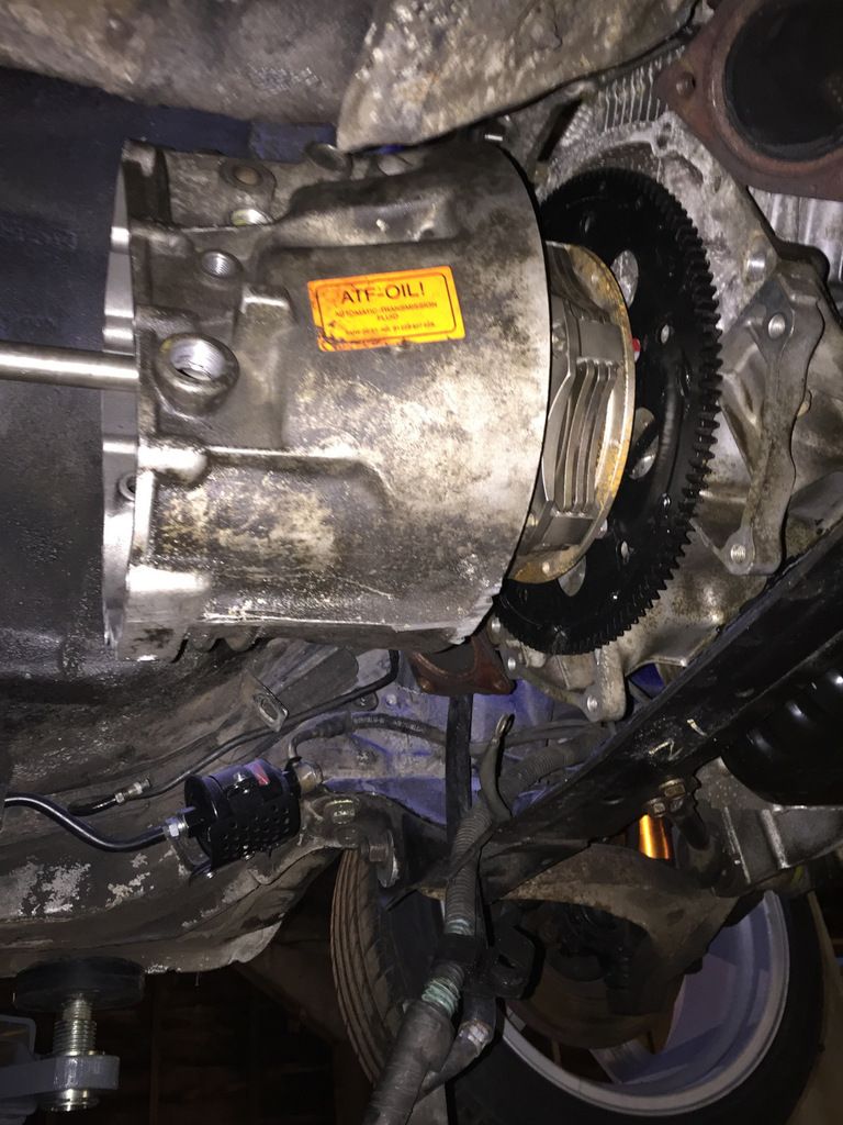

1 try splitting the BMW 5 Speed zf gearbox. These are know to be rock solid and to take 700BHP and lots of Torque. This didn't go well and we had to (Chris brought) A 20 tone press this thing is so cool and up there with the 2 post lift on things a workshop needs.

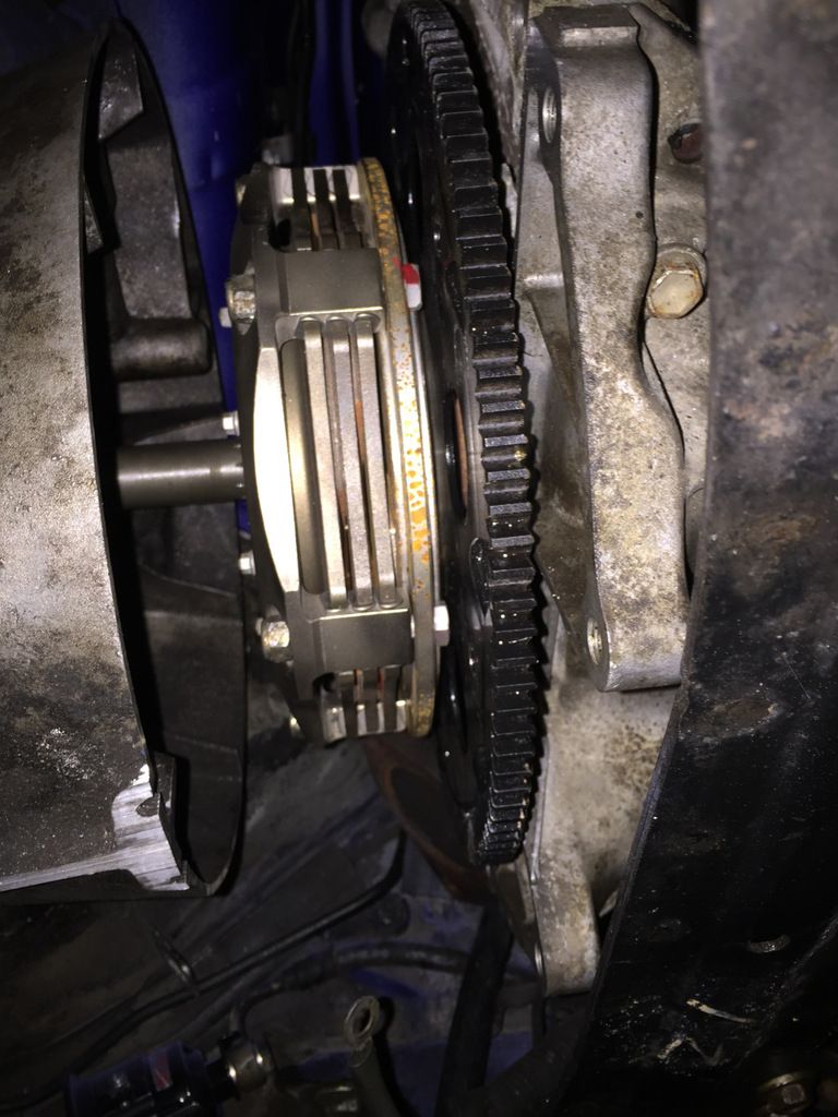

Next up was lots and lots of checking building taking apart marking scratching heads. We had to make an alignment bush to center the gearbox input shaft in the back of the engine then mouth the clutch. But we got there and we had this.

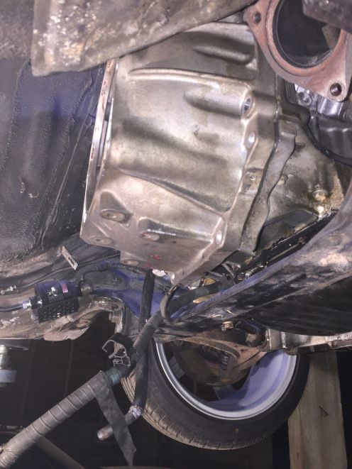

Next up we had to cut the Toyota/Lexus bell housing to match the the BMW ZF gearbox.
And after it was all cut them machined flat and parallel. It was much cleaning and prepping to weld it all together. Hear it is on my bench after being tacked in place on the car. It is now done.

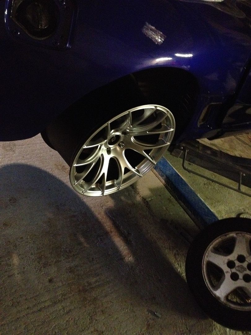

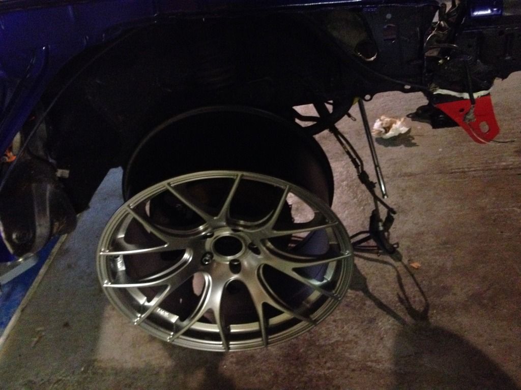

And Chris has brought some very very nice wheels. 19"x11" for the rear and 19" x9 1/2" for the front. We have checked and clearance is all good. This thing will look mental
