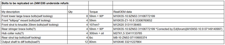

The only thing I can't find is the official torque for the 3no. M12 bolts that connect the front suspension struts to the steering knuckles.
Usually I could work it out from the steel tensile rating on the bolt heads, but these bolts have rusted heads and I can't read them.
Most guides I've found for E46 and E85 show the pinch-type strut arrangements that seem to be more common. My car is the 3 bolt arrangement, not the pinch type. I've failed to find any official data on this arrangement and bolts.
The only thing I've found is this: https://www.google.com/url?sa=t&source=web&rct=j&opi=89978449&url=https://club.autodoc.co.uk/pdf-manuals/club/bmw/z4-roadster-e85/strut-mount-and-bearing/pdf/EN-how-to-change-front-strut-mount-on-bmw-z4-roadster-e85-replacement-guide.pdf&ved=2ahUKEwjs-bDvob-MAxVHT0EAHQwUGLYQFnoECCEQAQ&usg=AOvVaw1idmjjBgnsghO3vx3mI8HY
^^ but I don't know this guy and have no reason to trust him. He states 107NM. But for an M12 bolt that would mean a 10.8 tensile bolt. If mine turn out to be 8.8 tensile then I'll snap the bolts and be in trouble.
