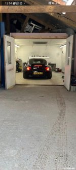

With the help of the guys from the original Basingstoke Z Sh ed - Joycey. The car was up on a ramp to assess the damage, nothing found other than alignment issues. We started to take bits off that needed new bushes and next thjng we knew, the subframe was out and we did a full rear axle rebuild. These were the parts replaced;
new sub frame, diff, and contol arm bushings
bolts
Lock nuts
powder coating
dust shields
bearings
trailing arms
lower wish bone control arms
braided brake hoses
New brake lines
Wheel refurb
exhaust mounts
Drive shaft mount
Drive shaft bearings
Drive shaft carrier bearing
Drive shaft coupler
Gearbox mounts
Front brake dust shields (to be fitted)
Front bearings (to be fitted)
Front Braided hoses (to be fitted)
Top mount reinforcement plates
Water pump (to be fitted)
Thermostate (to be fitted)
Vanos solenoids
Vanos filters
Engine mounts (to be fitted)
Suspension upgrade
Hood rubbers
Bodywork including paint
Wheel alignment
KN air filter
BC BR coilovers
Not all of these bits needed doing, I had them and we went for it. A total of 160 hours of labour have been put in by the team and we was able to get the coupe back on the road, driving and looking like new.
