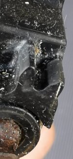

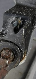

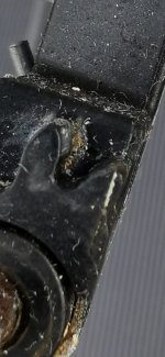

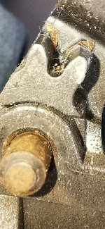

Hi !
So I worked on it today and this is what I found:
The 3 first pictures are about the driver side:
This one is the passenger side:
So I think the problem can come from this plastic gear as you said!
What can be done to resolve it? Should I change the handle or maybe just try to repair it by adding some melt plastic? I don't really know.
Great pics! Big difference in the profile of the teeth between drivers and passengers

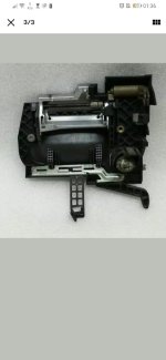

Is the wear plastic handle carrier you are talking about my previous picture or is it another part?
To conclude they are 3 parts that can be worn:
1) the cable which is part 22
2) the handle door which is part 1
3) the other side of the handle door which is part 4
Am I right or did I missed something?
