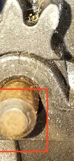

This slot should not allow the pin to wobble it should be a tight fit

The slot in the circle is worn, the pin will move sideways so the teeth move away from each other making them wear even quicker.
Yours look well worn mate!
If you look into the slot only half is worn, if you slide the pin further into the handle so it slides into the slot on the non worn bit it will be ok just glue a spacer into the other end to stop the pin from sliding back into the worn bit. Hope that makes sense.

You would require something metal about 3-4 mm and glued in with some epoxy.
You want as much contact at the worn end on the good bit that’s left so file the pin flat on that end.
Small nut or something similar will do as a spacer.
You can always buy a new one but when I was fixing mine I wanted to get to the cause of the issue, having repaired mine successfully with only replacing the handle because the teeth worn off it’s still working perfect 2 years on.
File this flat so you get as much contact on what plastic is left where this located.
