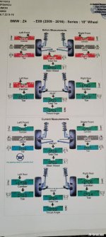

I have just dug out the Hunter alignment data sheet for last alignment and it is headed as a e89 ...are the settings the same for e85/e89??

As per a previous post does anyone know if geo settings for the e85 are same as the e89 ... 8)
Asked a friend who has a hunter machine and this is what he sent me. Hope it helps 👍🏻
So the machine should be selected to the correct model then, but in fact if you allow for all the tolerances they are broadly similar.

Thanks for that , I will dig out the last alignment readout and see how it compares :thumbsup:
