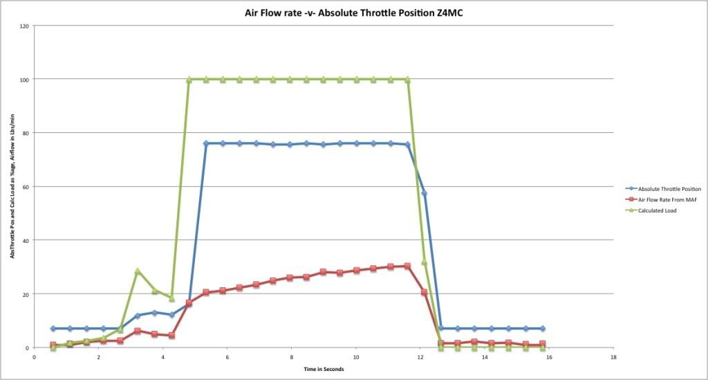

Here's a graph which I've produced from datalogging my Z4MC several months ago, with the OEM throttle maps.
"Calculated Load" is the percentage of accelerator pedal depression. As can be seen, at 100% Calculated Load, the ECU says that the throttle is only open by 76%, but whether this is true or whether this is genuinely WOT (i.e 100% open), I've yet to discover. However, as the graph shows, the Air Flow through the MAF progressively increases with increase in engine RPM and vehicle acceleration, despite the throttle being fully open throughout. Therefore, whether you are in Sport Mode or not, the time taken to fully depress the accelerator pedal is exactly the SAME, and you still need to floor the pedal to get maximum throttle opening/acceleration.
I'll do some more datalogging in Sport Mode to determine if SM increases the Absolute Throttle Position above 76% or makes any other changes.

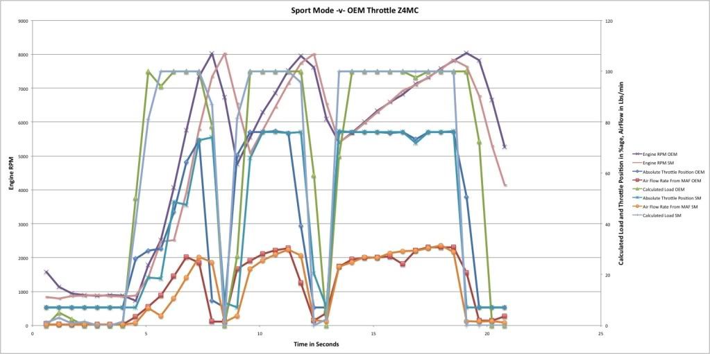

I did some datalogging today with the Sport Mode switched on and off. The DSC was on in all runs. Here is a graph showing the comparison of runs performed over the same route. The data shows that although the accelerator pedal was floored in 1st gear (i.e. Calculated Load), the Absolute Throttle Position (i.e. throttle bodies) do not open instantly, but instead, they progressively open, thus giving some form of "launch control". From previous datalogging, the Air/Fuel Ratio is also held at Stoichiometric level in 1st gear. However, in 2nd and 3rd gears, the throttle opens fully as soon as the accelerator pedal is floored. The rate of engine rpm increase is the same in all gears, whether or not the Sport Mode is switched on or off.
It appears to me from datalogging that there is no difference to performance whether the Sport Mode is switched on or off. The only difference it makes is as discussed earlier: i.e. you get more throttle response than OEM relative to accelerator pedal travel before it's floored. As I've said before, it's just a gimmick! :wink:
