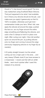

Also don’t know if this helps but this is how another forum member did it. He kindly gave me some advice on how to do it but I haven’t had the time/balls yet!
Now that you’ve tried & succeeded wonder what you think of doing it this way?
