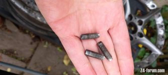

I was not so lucky. Three bolts would not shift, so I drilled off the heads in the end. Titanium is not easy to drill!
